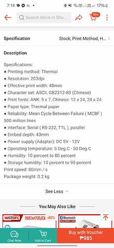

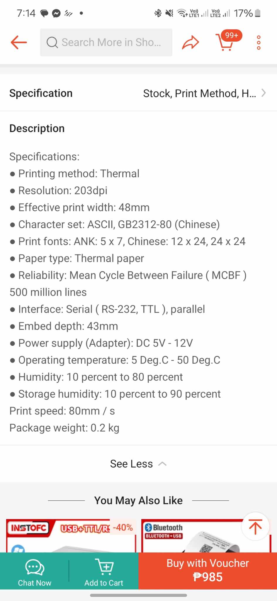

Link to actual product purchased, please.
Does the printer accept commands to change to a different font? It likely prints a 5X7 image for each ASCII character you send to the printer? There may be a different font set for your preferred language.
Says right there in the document that the font is CHINESE, so you got what you paid for, I guess.
You send an image, we cannot explore to see if there are options. Info in image is insufficient, leads one to belive there aren't any options. So, good luck.
but it prints English text for test print where it shows the voltage and baud rate
So, does the documentation show any commands relating to the font?
Some printers require a specific command to switch to ASCII or a different language set. Look through the printer's command manual for something like ESC R n or similar that sets the code page.
