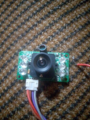

May I get help anyone with a camera code that is working please.
Check the camera data sheet to see whether it is programmable.
What leads you to believe that you can interface that camera to an Arduino.
What does the data sheet say?
Post a clear photo (no shadows) of the reverse side (and another of the obverse) so the silkscreen characters are legible. The array of LEDs suggests it uses IR (also).
This is the module: LinkSprite JPEG Color Camera TTL Interface - Infrared - SEN-11610 - SparkFun Electronics
In the tab "Documents" is Arduino code. The camera module seems to have Serial/UART interface at 38400 baud.
Nice find! The manual seems to be missing, though (Sparkfun link is dead).
I found this manual, but it is for a different LinkSprite camera model, with higher resolution images.

#include <SoftwareSerial.h>
/* Linksprite */
byte incomingbyte;
SoftwareSerial mySerial(4, 5);  // RX, TX         //Configure pin 4 and 5 as soft serial port
int a = 0x0000, j = 0, k = 0, count = 0;  //Read Starting address
uint8_t MH, ML;
boolean EndFlag = 0;
void SendResetCmd();
void SendTakePhotoCmd();
void SendReadDataCmd();
void StopTakePhotoCmd();
  Serial.begin(19200);
  mySerial.begin(38400);
  SendResetCmd();
  delay(4000);  //After reset, wait 2-3 second to send take picture command
  SendTakePhotoCmd();
  while (mySerial.available() > 0) {
    incomingbyte = mySerial.read();
  byte a[32];
  while (!EndFlag) {
    j = 0;
    k = 0;
    count = 0;
    SendReadDataCmd();
    delay(25);
      k++;
      if ((k > 5) && (j < 32) && (!EndFlag)) {
        a[j] = incomingbyte;
        if ((a[j - 1] == 0xFF) && (a[j] == 0xD9))  //Check if the picture is over
          EndFlag = 1;
        j++;
        count++;
    for (j = 0; j < count; j++) {
      if (a[j] < 0x10)
        Serial.print("0");
      Serial.print(a[j], HEX);
      Serial.print(" ");
    }  //Send jpeg picture over the serial port
    Serial.println();
  while (1)
//Send Reset command
void SendResetCmd() {
  mySerial.write(0x56);
  mySerial.write((byte)0);
  mySerial.write(0x26);
//Send take picture command
void SendTakePhotoCmd() {
  mySerial.write(0x36);
  mySerial.write(0x01);
//Read data
void SendReadDataCmd() {
  MH = a / 0x100;
  ML = a % 0x100;
  mySerial.write(0x32);
  mySerial.write(0x0c);
  mySerial.write(0x0a);
  mySerial.write(MH);
  mySerial.write(ML);
  mySerial.write(0x20);
  a += 0x20;  //address increases 32£¬set according to buffer size
void StopTakePhotoCmd() {
  mySerial.write(0x03);
archive.org to the rescue!
https://web.archive.org/web/20190616044738/https://www.linksprite.com/upload/file/1291522825.pdf
