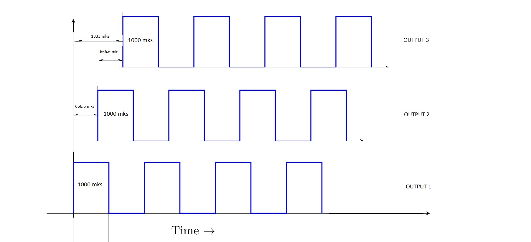

Hi all. There is a task to write logic for three square amplitudes shifted in time and with the same frequency. I'm attaching a picture. Any ideas, I’ll be glad and grateful I need this logic by arduino cc code.

Flip the outputs every 333.3 mks in a round-robin fashion.
Sorry my mistake, unit is mcs
time shift 666.6 µs. Take a look diagram
Guys, the time values are conditional, I need a structure in which I myself will change the numbers
You don't understand what I wrote.
Look at the diagrams, the outputs change round-robin all 333.3 units.

You could run this using a 333.3 us timer, cycling through a simple switch case for the 8 output states. Then, all you need to do is program the timer interval.
Does the 4 cycles, starting, and ending sequence matter or not?
What is the trace 3 value at t=0, or the trace2 value at 800 units?

  1. Is output 3 HIGH at t=0, and moves to LOW at t=333.3 mks.
  2. Are these 0.5Hz square waves?
  3. Or are these 500Hz square waves?
  4. is 0.5% accuracy OK?
  1. the same time possible positions
    low low high
    high low high
    high high low....
    Yes all the circle (1) divides for three pieces 0.333 each
    2-3. Yes common frequency 500 Hz
  2. Quite acceptable

There are three independent outputs here. Each output has the same flip frequency of 1000 µs. The difference is that the amplitudes at the outputs are shifted to each other in time by 666.66 μs.
