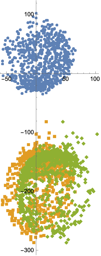

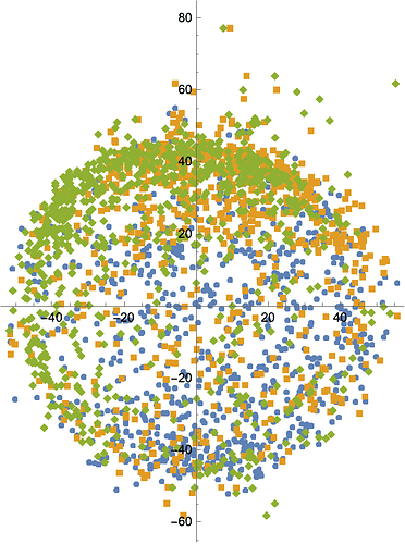

Hi thank you for replying!
Look this is my sensor image before calibration
and after calibration
So it looks OK to me (not perfect, but fair enough).
