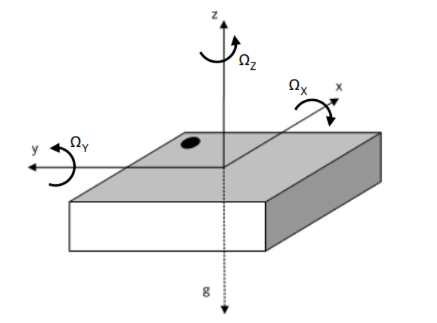

I'm sorry I am no expert in the theory of sensor fusion or AHRS, but I know that if the output drifts or responds slowly, it must be the orientation of either sensors not aligning. I am currently using the SensorFusion Madgwick algorithm to fuse the sensor values.

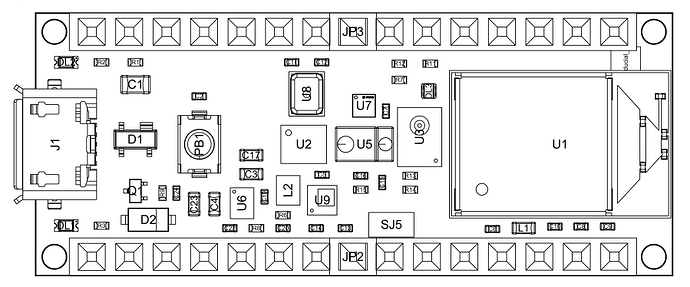

There was already a thread on this issue on Madgwick sensor fusion with Sense Rev2. But didn't seem to help me. I tried the advice on figuring out the orientation of the IMU and the magnetometer, I found out that the axes lined up the same way as the ICM-20948 shown in the answer (not the notch, but the magnetometer Y and Z being inverted in respect to the IMU). Below is the picture from the Nano BLE Sense Rev2 chip layout, BMI270 and BMM150 datasheet respectively.

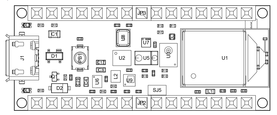

In the chip layout, U2 is BMI270 and U7 is BMM150, and the notch is aligned, so the magnetometer Y and Z axis is inverted. So I apply the corrected the value and apply it as per the answer, and the code is as below.

You have the right idea, but keep in mind that the The Earth's "North" pole is a south magnetic pole and that for accelerometers, the acceleration due to Earth's gravity is measured as "up", along the positive Z axis.
You need to double check your assignment of axes by printing out the raw magnetometer measurements. In the mid-latitudes of the northern hemisphere, the Earth's magnetic field points rather steeply down into the ground. Look up the details for your geographic location on line. Make sure that after any axial changes you make, the raw data correctly represents the direction of the Earth's field vector.
This won't work:
fusion.MadgwickUpdate(gx, gy, gz, ax, ay, -az, mx, my, mz, deltat);
The mag/accel axial assignments are both right-handed as defined by the manufacturer, and any swaps or sign changes you make must maintain that right-handedness. The above defines a left-handed accelerometer axial system.

If the dots on the ICs are in the same orientation on the the PCB, I suspect that the correct axis reassignment is this one:
fusion.MadgwickUpdate(gx, gy, gz, ax, ay, az, mx, -my, -mz, deltat);

What you did above is correct. However, as the sensor ICs are mounted on the PCB, the magnetometer and accelerometer Z axis definitions disagree, and that has to be corrected or the fusion algorithm simply won't work.
After carefully reviewing the data sheets for the two sensors, and assuming that the code does not change the default mapping of the sensor axes, I am fairly certain that the correct remapping of the magnetometer data is this one:
