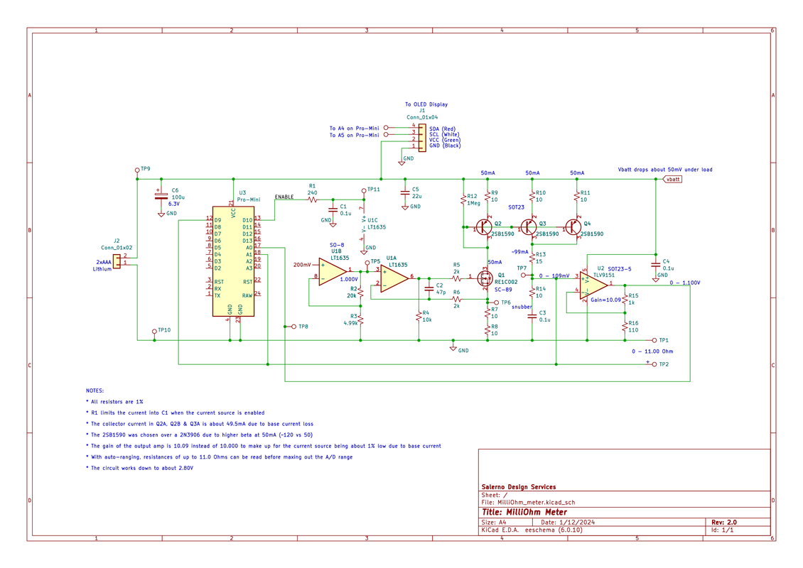

// This is a Milli-Ohm meter. It can measure resistance from 1 mOhm to 11.00 Ohms, using a Pro-Mini board (3.3V),
// a 100mA constant current source (LT1635) and a diff amp with a gain of ten (TLV9151) to gain-up the voltage drop across the load.
// The current source is turned on for a short time, and the voltage drop across the terminals is measured and gained-up by 10.
// The resistance is calculated and displayed on an OLED display.
// There is an auto-zero phase at startup that allows the lead resistance (and any internal offsets) to be zero'd out.
// Modified the auto-zero code and added an auto-range feature to measure resistances up to 11.00 Ohms.
// Had to add a "dummy" analog read a few seconds before it was need to "wake-up" the internal reference!
// Rev 2.0, 1/20/2024, D. Salerno

If those two are in series, you have to connect it to the RAW pin. Not the VCC, unless you want to blow up the processor.

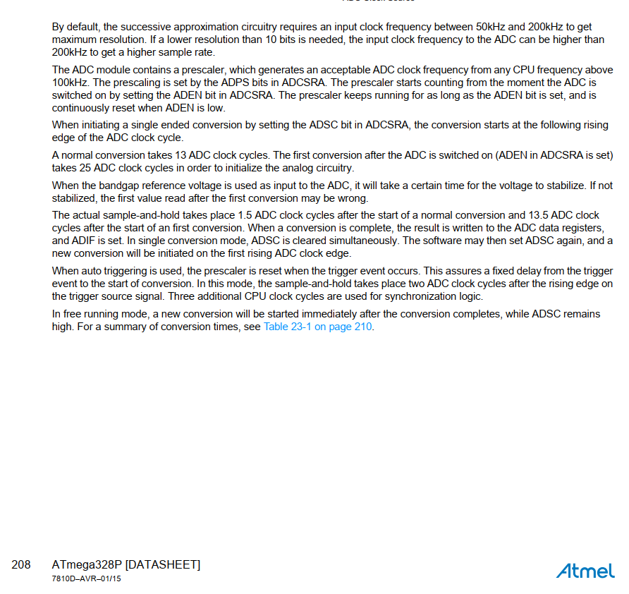

When changing the analogreference, it's recommended to discard the first two ADC readings, to give the changed reference time to settle.

I literally gave the reference SECONDS to settle. My point was that it was clear on the 'scope that the reference was sitting at Vcc for seconds until I did the first analogRead, at which point it dropped to the proper 1.10V.

analogreference is only telling analogread what reference it should use, but the actual switching takes place at time of analogread.

The analog reference is not actually set till you do the first read
So after you set the reference with analogReference (INTERNAL) do a dummy analogRead

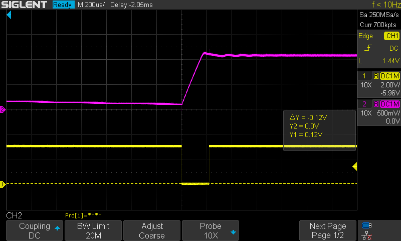

Not to belabor this, but I ran a simple test where I measured a fixed input voltage (0.306V) that was applied to the A0 input of a 3.3V Pro_Mini board. (What the heck, I'm retired, haha.) I did three analog reads, 1msec apart and printed the resulting A/D values to the serial printer. See the code below.
First I manually measured the voltage at the Vref pin of the processor, and it was 1.090V, so the A/D reading ("count") should ideally be 287.
The first A/D reading (after applying power or doing a reset) was 268. After 1msec, all the subsequent readings were either 286 or 287. (I also ran a test where I took many readings). So the first A/D reading had an error of 7%. After 1msec the readings were all within 1 LSB of the correct value.
You'll see in the code that I also turn a digital output on and off and on again. This provides me with a trigger for the 'scope. I took a scope photo of the voltage at the Vref pin of the micro, and after a Reset, it showed the voltage rising linearly from 0V, with some overshoot, to ~1.1V. The rise time was 200usec. However, after that it took a few hundred usec more for it to really stabilize and smooth out.
Based on this test of one, I would always wait at least 1msec between the first (dummy) analog read and any subsequent reads that you care about.
I just thought some people might find the results interesting. I'd attach the scope photo for reference, but I don't see how that's done (being a Newbie).

I posted a link to the scope photo here:
The top trace is the reference, the bottom trace is the digital output "enable".
The analog read takes place immediately after the digital write command to set enable low.
That's why we do the dummy read and throw that value away.
I used a 3.3V Pro-Mini board and some other analog hardware to build an accurate MilliOhm meter with an autozero function.
Can you provide a schematic so we can see how you have everything connected?
Schematic for pro mini
you will see the external reference is decoupled to ground on the board via a 0.1uF cap.
From the 328 data sheet this shows the reference is selected by the admux register.
When reference - internal is selected the reference supply connects to the DAC AND the external reference pin.
That is why Reference-EXTERNAL MUST be selected FIRST if you apply a voltage to that pin.
Then the AREF charges the 0.1UF from the source impedance of the internal reference.
Hence the delay.
I understand why there's a delay for the Vref pin to rise, I just thought it would have occurred after the analogReference(INTERNAL) command, and not wait for an analog read.
Exactly. Understood.
Here's my schematic.
