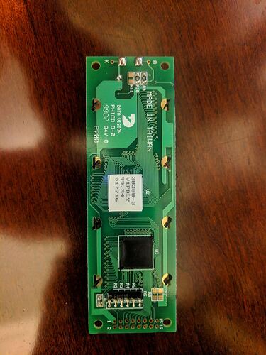

Unfortunately, I ordered these parts at my local hobby shop. The only information I can provide on the display is that it is a Samsung LCD Display 2 line 82x18mm. I purchased these items under the impression from the sales staff that they would be 'overkill' for the project I have described.

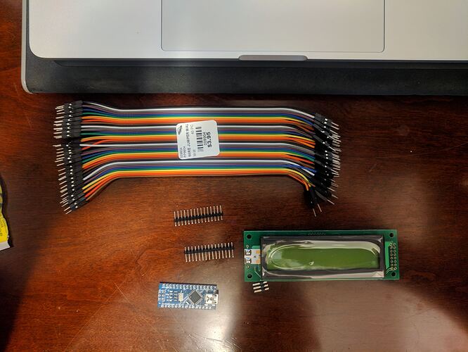

Pics of the items purchased.
From the looks of it I'd guess it can be addressed as a standard 1602 LCD display, but the PCB layout is highly unusual. A quick Google search doesn't yield any useful information, but I did find images that are quite similar to yours.
I think you best get back to the shop, ask them for a detailed pinout or (even better) data sheet of that part. If they can't give you the information on you how it is to be connected, ask your money back.
Before buying any part, make sure you know how it's to be connected, and for more complex parts such as displays and sensors make sure an Arduino library exists (or you know how to read it without).
I apologize for the misinformation. The product I purchased is a Data Vision Phico 9902 94v-0. Unfortunately, the store nor the infinite wisdom of the internet can divulge any information pertaining to such a unique part.

To me it looks like a standard 16x2 with an end header layout. I have a couple of these and they follow usual pinouts.
If you look closely at the pic they have markings 1 to 16 each which line up odd/even number sides. They follow usual 14 pin plus backlight 15 16 also as Anode (K)Cathode at opposite end.
LiquidCrystal library works with them.
You are correct that there is no usable information in that string other than 9902 being a design date code of manufacture and 94v-0 is the circuit board material flammability specification.
For some reason, I had assumed it was a graphic display, not character, since you’ll be quite limited with respect to animation. The jumper wires would have been more useful as female to female. As is, they’re pretty useless unless you have a solderless breadboard between the Nano and the display.
How’s your soldering skills? Ever install header pins?
