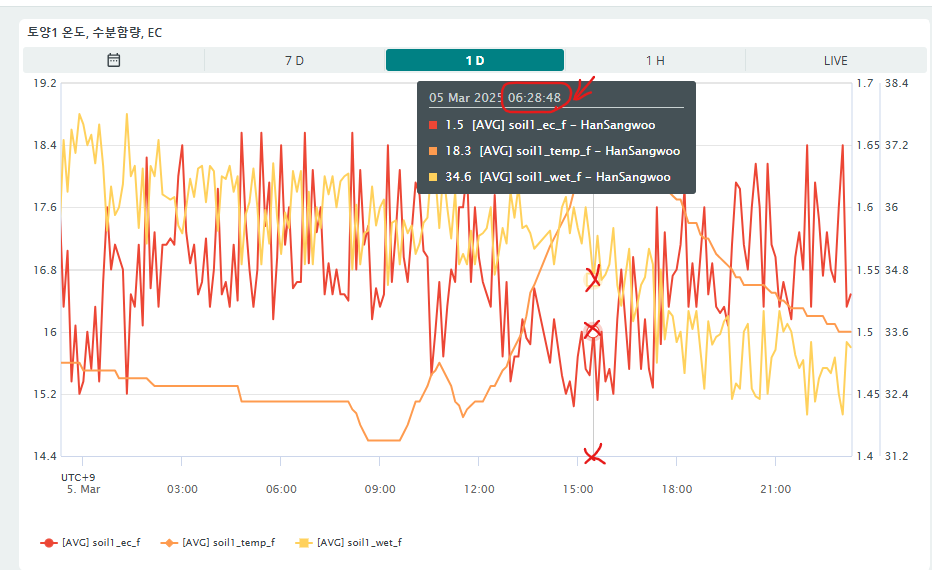

Time Stamp in graph. The time on the x-axis is correct
After arduino updated, I found something wrong on my graph. What happend to my graph?
hey, it's because your board send the time in UTC+0 and you display it in UTC+9
Thanks a lot for your quick answer.
