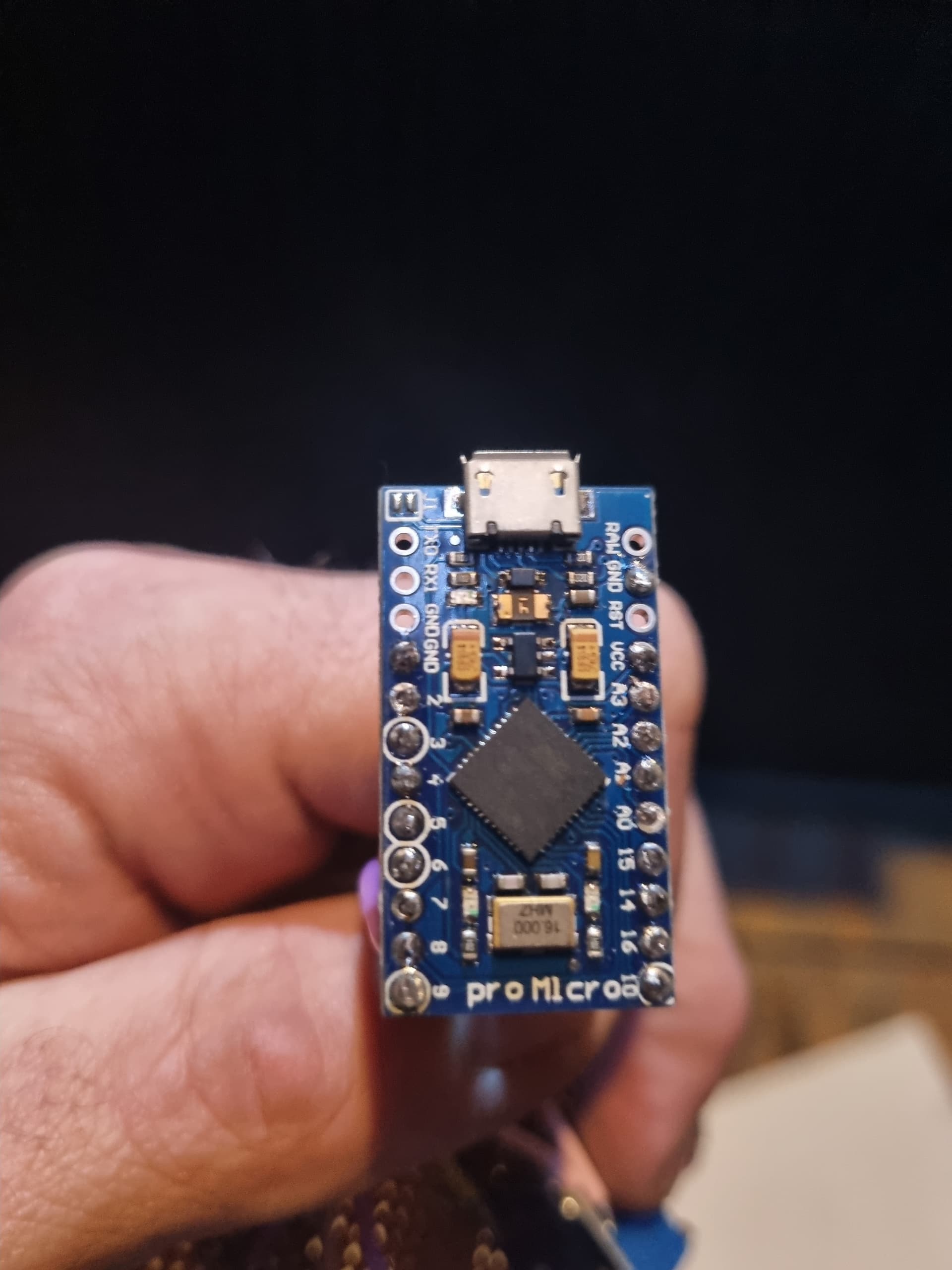

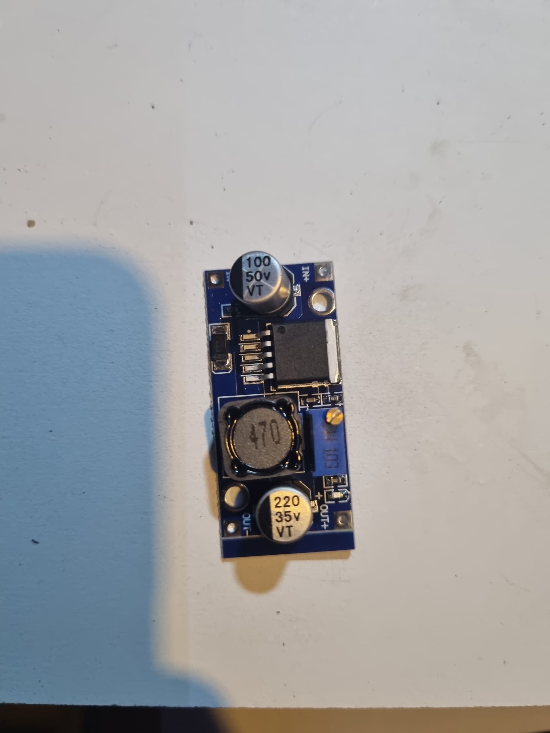

I found a project online, and it suits everything I need for it. I've gathered all the bits, which include;
- Pro Micro (Project calls for Pro Mini)
- Relay
- Digital Encoder
- Buck Converter
- Power Switch
The Arduino loads the code, which reads

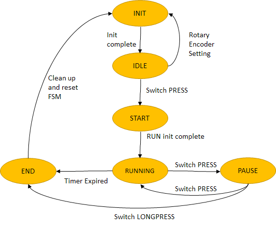

Function
- Arduino manages the display as a multiplexed POV refresh using direct I/O
- Rotary encoder allows setting the required timer value
- Rotary encoder switch used to start the timer
- Timer can be paused with a press of switch. Second press resumes and long press ends the timer.
- While timer is active (running or paused) the relay output is switched on.

// Finite state machine states
typedef enum state_t { S_INIT, S_IDLE, S_START, S_RUNNING, S_PAUSE, S_END };

Does anyone know how to wire/ code the Micro Pro to make this circuit work?
I had a full head of hair when I started, and now I'm down to two strands...
Thanks so much in advance
