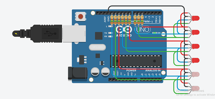

The code for this is quite simple, digitalWrite(Red#, HIGH). The same is true for the others but why is the last two quite dimmer than the others? I've tried analogWrite(Red#, 255) and that works, but I'm hoping to make it a consistent digitalWrite.
Did you forget to set those pins to OUTPUT?
Check line 42; it's almost always line 42.
Seriously, show us your sketch. None of us are mind readers.
Sorry, kinda forgot to do that but it solved now, anyway. Thank you.
I've checked, and yeah, I forgot. Nice deduction! Thank you very much!
No problem. Seems my crystal ball was working today. Should have bought a lottery ticket.
If you want to know the problems I can see with your circuit, just ask.
