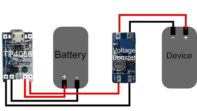

Hi everyone, I am having a problem when I connected the Arduino to the tmp36, it seems to read properly and I coded for the fan to adjust the speed to the corresponding temperature. However, as soon as I unplugged my Arduino from the computer, the fan just ran at max speed without speed adjustment whatsoever. I was thinking that it was properly due to tmp36 not reading anything when I disconnected the board from the computer. Any solution for this?
My circuit consists of 2 lithium batteries that are powering L298N (connected to the motor) and I connected the 5v+ and the GND of the L298N to the Arduino to power the Arduino.

You have a power supply problem, without an annotated schematic showing how you actually wired it showing all connections, power, ground, supplies etc I cannot be of much help. Also post links to each of the hardware devices. Your choice of motor driver is about as bad as you can get. You lose about 3 volts to your motor using that which is burnt up as heat.

I made the circuit based on this:
Instead of the voltage booster, I have 2 lithium batteries providing 7.4V to the board. And I hooked L298N to the Adruino similarly to this video: https://www.youtube.com/watch?v=Ey4xoG970Go&list=LL&index=32&pp=gAQBiAQB&ab_channel=educ8s.tv
Also, I measured the voltage of the TMP36 when connected to the Arduino and it seems like it was received 4.2V for the 5V and 3.3V spot on when I joined it to the 3.3V+

Sorry for my lack of work ethic. I have drawn this out, hope this helps, and feel free to make any suggestions to this! The drawing is the continuation of the schematic I posted above. Instead of "device", I replaced it with the schematic down here.

Hi, @kipd4321
Welcome to the forum.
Please show how you are powering your project with the PC disconnected?
What power supply are you usig?
