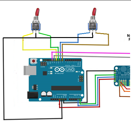

Toggle Switch instead of On-OFF Button for Servo Driver?
I have PCA9685 Servo Button control aimed at Model railway point/turnout control wiring diagram and code.
But I would like to use the 3 pin toggle switch instead of the button as the diagram shows.
How can I wire one toggle switch each servo and do I need to edit the following code?

What functionality do You want from the toggle switch that differs from the button operation?
Each toggle switch will be operation one servo but diagram of the above each servo has been operation 2 button. I would like to convert one toggle switch instead of 2 button for cosmetic also.
grafik
    This example uses 2 servos, one on Pin 0, the other on pin 12 of AdaFruit PCA9685 module
    Relays are on pins 12 and 13
   1 PCA9685 board
   2 servos
   2 3-pole switches
   2 relay modules
   SDA/SCL connections for PCA9685
  Arduino UNO: A4 (SDA), A5 (SCL)
  Arduino Mega 2560: 20 (SDA), 21 (SCL)
  ESP32: 21(SDA), 22 (SCL)
  pins 8 - 11 for buttons/switches
  pins 12-13 relays

Do your SPDT switches have a center OFF position, or are they simply LEFT or RIGHT, no center position?
My SPDT switches are only simply Left and Right switches. So, there is no center position.
Miniature-Toggle-Switch-MTS-102_600x600
Thank you for diagram and code.I will try tuesday night and will be inform.

Change the instantiation of the pwm object from
Adafruit_PWMServoDriver pwm();
to
Adafruit_PWMServoDriver pwm = Adafruit_PWMServoDriver();
It's working now but the issue is that the toggle switch works only when Arduino is connected via USB.
The toggle switch not working when 5V connected the pca9685 servo driver.
