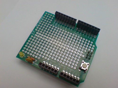

Hi, I'm new to electronics. I was going to get a breadboard and start screwing around but decided to go with the Arduino since I'm in the computer field and wanted to have something interface with my PC. Anyway, when my board finally arrives, I'm going to start slow and learn as I go along. You know, make some LED's blink and what not. However, I'm kinda confused on what a shield is. The kit I ordered comes with a proto shield and I assume that just allows you to stick a breadboard on top of the Ard. What about motors? I have few RC car motors that I was thinking of lighting up. Do I need a motor shield for that? Is there a good beginner doc I can read that covers these types of questions. Thanks! I look forward to this hobby.

An Arduino shield is basically any board that you can attach on top of the Arduino. Some of them are specialized into a specific task (eg. an Xbee shield or motor shield). A protoshield is a protoboard (NOT breadboard) that plugs into Arduino allowing you to expand Arduino with your own homemade SOLDERED circuits. Like this:
Attaching a mini solderless breadboard to the protoboard isn't really what it's for, but I guess you could do that.
