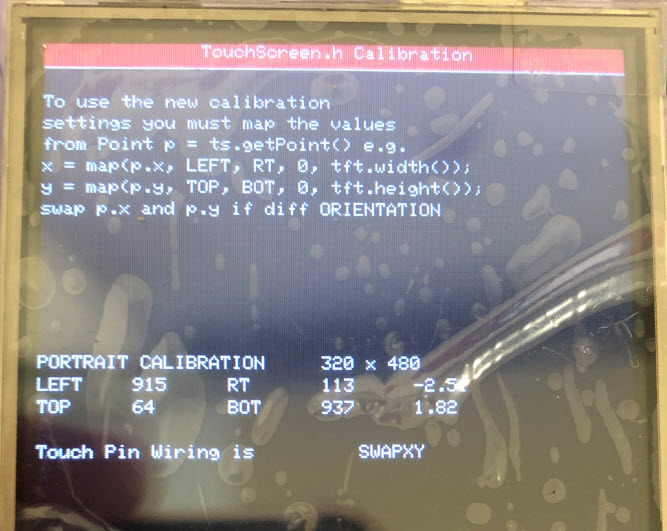

I have an issue that I am trying to sort out. I am using an Arduino Mega and a 3.5'' TFT Screen.
As I move away from the ribbon side of the screen the touch location does not match where the screen detects the touch. It progressively gets worse the further from the ribbon side of the screen you get. ( see images). I am unsure how to correct the issue. Any help would be appreciated.

Hello,
Thank you for your quick response, sorry for the incomplete information.
The Screen is made by Kuman
The Libraries I am using in the sketch are (they were included on disk that came with the screen) :
#include <Adafruit_GFX.h>
#include <MCUFRIEND_kbv.h>
MCUFRIEND_kbv tft;
#include <TouchScreen.h>
I did run the screen calibration from the example that was included with the screen, I attached an image of the results.
I entered the values provided into the sketch:
uint16_t TS_LEFT = 915;
uint16_t TS_RT  = 113;
uint16_t TS_TOP = 937;
uint16_t TS_BOT = 64;
Again, thanks for the help.

Hello,
I checked the versions per your request. ADAFRUIT_GFX version = 1.0.2 ( looks VERY old) the MCUFRIEND_kbv, does not show as being installed by looking in the library manager, but the fact that i can load the sketch would suggest otherwise. Now i know in the future, not to rely on the disks and reference library manager. I have deleted both and will re run the calibration. Thank you again for the help.
[solved]
I verified the settings in the new libraries per your suggestion. The numbers actually matched very closely to what I already had. I entered the new numbers in but with no change. I tried a secondary screen, at first it still seemed off a little, but was much better so I ran the calibration again on that screen and it worked. The screen was defective, thank you for your support and help, sorry for the delay in responding back with the results.
