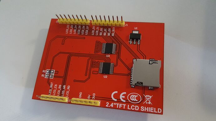

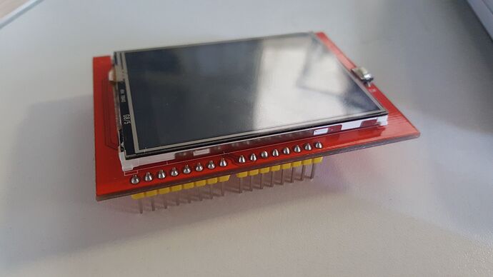

Touch Screen TFT LCD Shield 2.4" on Arduino Mega
I BOUGHT THIS TOUCH SCREEN SHIELD:
IT WORKS WITH ARDUINO UNO, BUT NOT WITH THE MEGA.
THIS IS THE PROGRAM:

IF I PUT THE SHIELD ON ARDUINO MEGA LIKE I DID FOR THE UNO, IT DOESN'T WORK.
What can I do?
Thanks.
prova_touch_screen_senza_ritardi.ino (3.74 KB)
On Mega you have to use different pins, connecting LCD D0-D7 to pins 22-29, so you can not just plug the shield on the board. I suggest to read the Adafruit_TFTLCD library files for details.
Cheers, Ale.
Hi.
I use "same" 2.4 cheap ebay display with this code.
2.4 tft
Same code for UNO as mega.
Just check on code how it is initialized.
