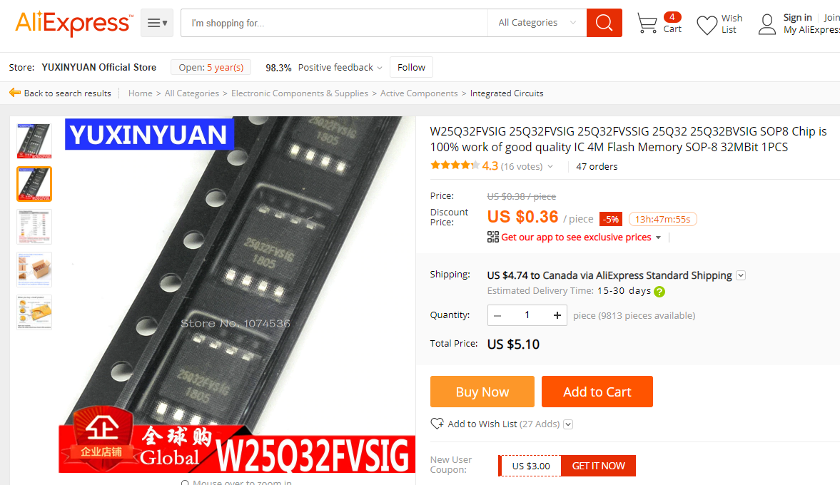

Another idea: Can I just get a Moteino M0 with a 4Mbit Flash chip, de-solder it and add a new 32Mbit flash chip, such as:
You can order the Motino M0s without the flash chip, and add your own, I suppose. But ask the seller first in case the chip you plan to add is incompatible. Soldering something on is always much easier than unsoldering, in my experience. Removing components always risks damaging the board by lifting/tearing PCB tracks. But even so you will need good eyesight, steady hands, a good quality temp controlled soldering iron, and the skills to use it. Would stick with the SD cards myself.
