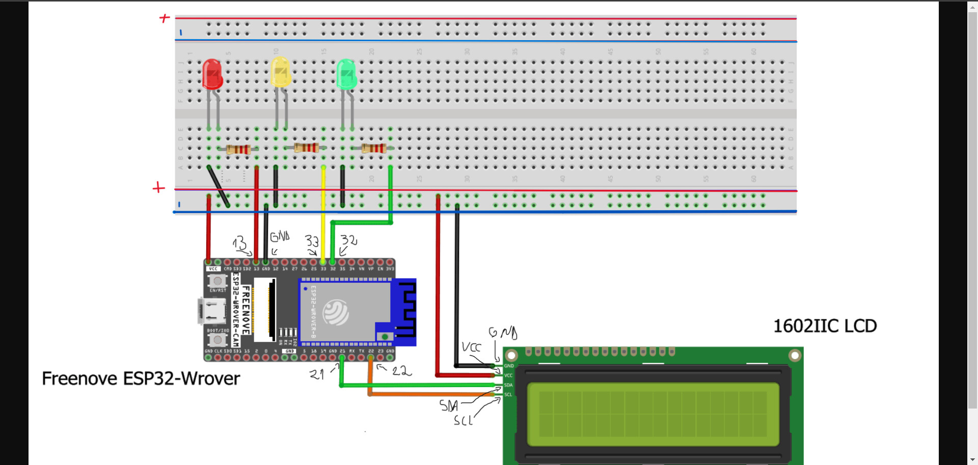

I want to build a Traffic Light with LCD in which time left for signal will be shown. I manage to make the wiring (see the diagram) and also I build the code.

My issue is that when I'm running it, the text is print it on my LCD but the lights are off completely. Do you have any idea what could be the problem with my lights that are not on?

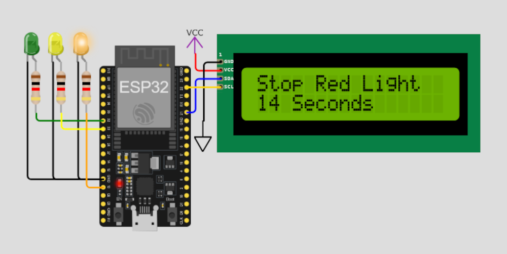

Your code works! Verify your LED wiring (Anode toward Signal, Cathode toward Ground)
diagram.json for wokwi

Sorry I cannot follow your picture, the wires connections are not defined.
Please, show a photograph of your project.
Indeed my LED wiring was wrong! Now it works fine! Thank you for suggestion!
The second is better but they do not show the LED orientation. I use SMD and they do not look like this and the resistor labels are missing Some users are color blind. .
