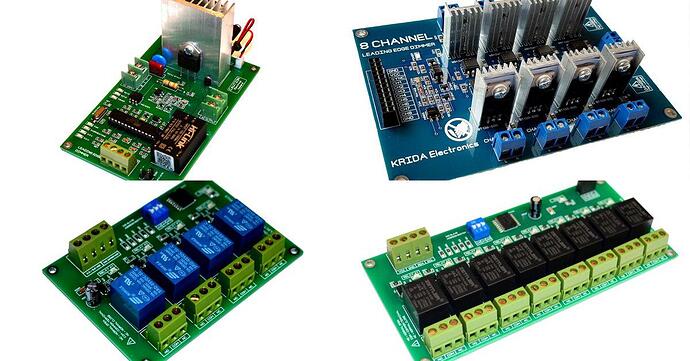

Here is a 2 channel triac type dimmer compatible with Arduino:
There are many many articles on the web for DIY Arduino triac phase controllers. Please don't attempt DIY if you are not skilled in this type of endeavor since 220 v mains is very unforgiving and one mistake is one too many.
