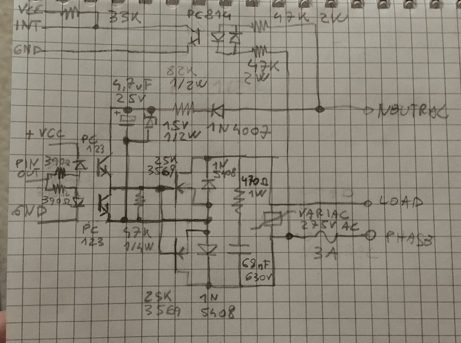

Hi, I post the scheme I've designed to realize a trailing edge dimmer, to drive dimmabel LED bulbs of my home. Unfortunately there isn't any shield available in the market made for this purposes and the triac leading edge dimmers don't produce good results with dimmable LED bulbs.
I hope the idea is interesting and somebody decide to produce it, I have several others to realize.
More infos here: A very efficent zero crossing dimmer (direct pin control from timer) - #8 by GiovanniG11

Thank you, I've found the module, it cost 25$ wich is not a lot but not also a few. It includes a dedicated microcontroller which measure analog input (can be from potentiometer, or from PWM source), and do the job itself
This has 2 negative reflections, the cost is more than simple hardware i desiged (wich actaully needs less components and connections) and it looses the educational purpose of drive manually the mosfets and give a full control of output.
The mosfets I used paralleled by diodes give chances to obtain more than 500W declared by Krida Electronics

Figuing out how ESP8266 managing the hardware pins driven directly by times give a chance to create cheap trailing edge dimmers working by WiFi. It's just necessary to manage the power part of scheme to power ESP too

In this case triacs are used as simple switch, starting with zero crossing, it's the same use of solid delay which are sold for few $. They have minus that they get hot and not power efficent like a pure contact.
A soft start of motor can be achieved as well with such switches, counting zeros and leaving only a few % of waves to energize motor, till 100%, in this case a board like this has sense, but it's not leading cut of waves.
You'll never see a motor driven by leading edge dimmer, if so, it's a mistake with different unpleasant results.
Leding edge triacs are concept of the past, a very cheap and simple way to dim the incandescent light, we need to look the future.
