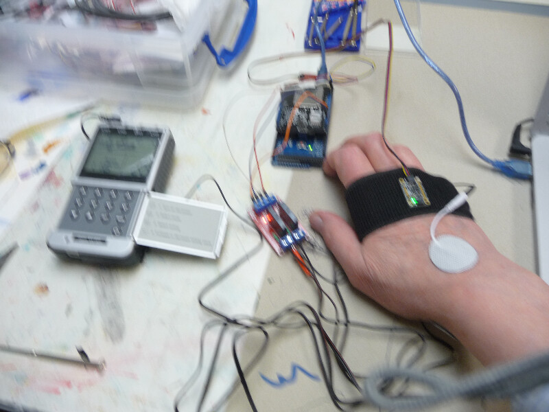

Here are two photographs of my proof of concept stimulus device that I got working today, February 19, 2022.
This proof of concept test rig consists of a TENS unit I purchased from Amazon for about $100. It has the advantage of being battery powered so it is portable and there are no dangerous voltages or currents involved. My hand/arm tremors inspired me to deep dive into the research papers on Essential Tremors. All the online, freely accessible information, led me through a convoluted path that was littered with many interesting ideas and more than a few disappointments; "The best of the best (treatment) only works for about half of us ET sufferers!".
Aside from the learning curve and the technical challenges, I wanted to see if it was possible to build an affordable device that was free for the substantial recurring costs of the commercial offering mentioned above. Recurring costs are: a small amount of electricity necessary to charge the TENS unit and three round TENS self adhesive electrodes: cost about $0.50 each and they last a week or so. This "proof of concept" device is only the first step. I have already started sourcing parts for the next version. The control unit will be battery powered, portable, and will have a much simplified design.
The output of the TENS unit is switched between the Medial nerve and the Radial nerve by a pair of Solid State Relays (SSR) seen next to my thumb. The switching is controlled by an Arduino Mega 2690 microcontroller just above and to the left of my forefinger. The Mega 2690 also measured the frequency of my tremors via a 3-axis gyroscope/accelerometer combo IMU mounted on a Velcro strip on the back of my hand. Total cost was about $175 excluding taxes and shipping.
