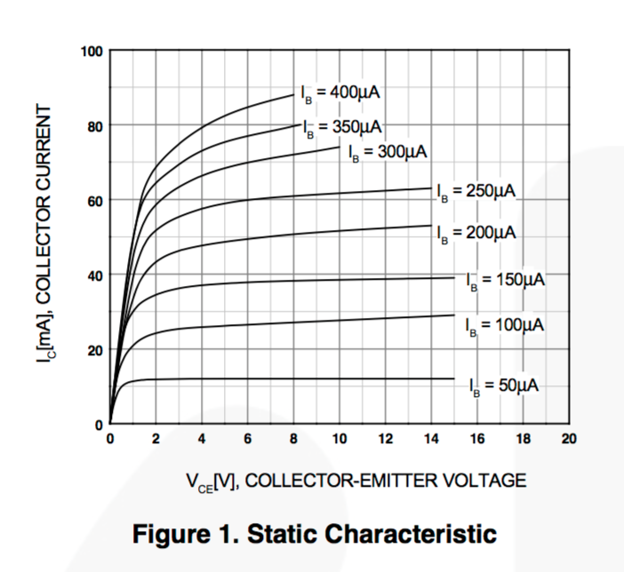

This is not true. Look at fig. 1 of the transistor spec. When the transistor saturates all the base currents converge into a straight line on the characteristic curve. You can see on the graph that when Ic=20 mA then Vce is the same value for Ib=.15mA as for Ib=.4mA. In both cases Vce=.4V. The collector current dissipates 20mA*.4V=8mW in the transistor in both cases. But the base current dissipates .15mA*.8V=.06mW in the first case and .4mA*.8V=.32mW in the second case. Contrary to a noticeable decrease, the power dissipated in the transistor increases slightly as you increase base current.
There is no advantage to increasing base current in a saturated transistor.
You're wrong, and just seeing what you want to see. With Ic =20mA, I see a slight difference between Vce at Ib = 150uA and Ib = 400uA
It's not a "straight line" at all. At 20mA, the line is much thicker than a 'single line'. (It's "noticeably" thicker, possibly 4-5 times as thick, but hard to see on this scale.)
You recommend about 430uA base current. I say 2mA to 4mA. If you were to draw a line on that graph for Ib = 2mA or Ib = 4mA, the Vce would be noticeably lower at Ic =43mA. It's true.
There is a very good reason that the datsheets quote Vce(sat) at a forced beta of 10 or 20.

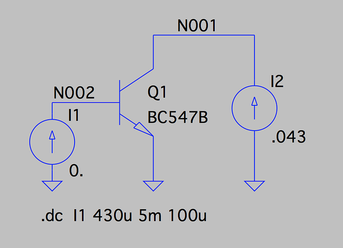

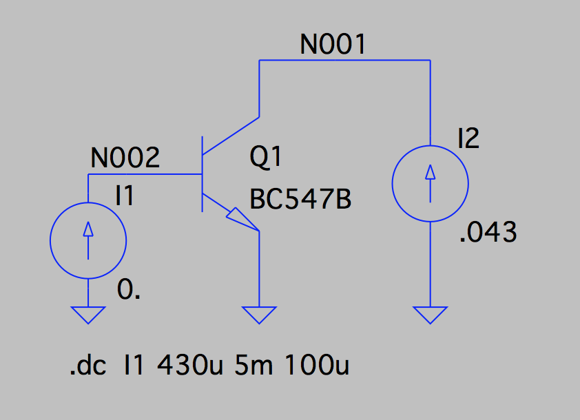

Facts, no argument. I did a simulation for the exact device we are talking about under the exact conditions we are talking about.
horizontal axis = base current
vertical axis = power
total power = red
collector-emitter power = blue
base-emitter power = green
Yep. Note that at your recommended base current of 430uA, total dissipation is higher than at Ic/20, which is what I was saying all along, and my test showed the same. (According to the datasheet, although I used a BC548B for my test, the specs are identical.)
Looking at your graphed results, it's not until the base current reaches about 3.5mA with a forced beta of about 12 that total power dissipation gets back as high as it was with 430uA base current.
So the bottom line is that my recommended base resistor values of 1.8K to 2.2K from reply #6 would result in 1.9mA to 2.3mA base current, with a respective beta of 22 to 18.7 and total dissipation almost 1mW lower than with a base current of 430uA. Not quite ideal, (which I claimed), but pretty close.
