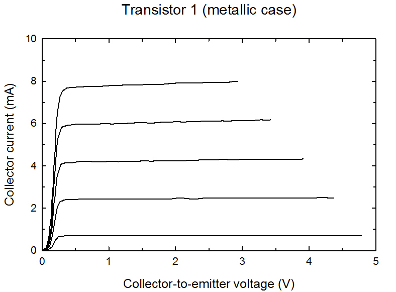

I would like to share with you my last project, a transistor curve tracer using Arduino.
The idea is simple, i. e., to obtain the output I-V curves of a BJT by reading the voltage drops at the transistor when separate voltage sweeps at base and collector are applied (using a couple of DAC converters).
The project is conceived for educational purposes, so I do not expect to get very accurate curves as those provided by professional (and expensive) characterization systems. I intend just to be able to show to the students reasonable and realistic I-V curves corresponding to the discrete transistors they are using in lab work, getting those curves in the same lab for each specific transistor.
Up to now I've developed the Arduino sketch, that you may find below. The results are printed to the serial output, so you just need to copy&paste them to your favourite plotting software (Excel, SigmaPlot, etc.) to get the curves (just take into account that the data are repeated each time the main loop is run). The next step is to develop some Processing code to plot the results directly, getting the average values for several runs. In any case, all ideas about how to improve the project are welcome!
Here's the circuit (all connections are explained at the sketch)
And a couple of measuments I did with two different npn transistors

  1. you might zoom in in the 0..1V area as that might be the most interesting part (are smaller steps possible?)
  2. you might calculate the steepness between 0 .. 0.25V and the one between 1-5V
Smaller steps are possible, yes. You just have to modify the sweepbase and sweepcollector values.
