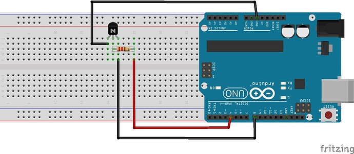

I'm attempting to test a 2N3904 Transistor with an Arduino UNO R3, for starters I believe I haven't coded the program correctly. Secondly I'm not sure if I understand the Transistor correctly either.
I have the 2N3904 Transistor on a breadboard, I have a connection going from Pin 4 of the Arduino to one end of a 10K resistor, the other end of the resistor going to the Base Pin of the 2N3904.
The Collector Pin is connected to Ground of the Arduino, the Emitter Pin to Pin 8 on the Arduino.

When I run the program & view the Serial Monitor, I only see "BasePin LOW" it doesn't go HIGH but if change unsigned long TransistorOnTime = 4000; to unsigned long TransistorOnTime = 2000; and then do the same for the off time From: unsigned long TransistorOffTime = 2000; To: unsigned long TransistorOffTime = 4000; The result from the Serial Monitor is always "BasePin HIGH". My Subroutine "void Pulse_Read()" is not returning any results on the Serial Monitor in either case.
Have I tried to base the coding off of the Blink Without Delay / Flash Without Delay examples.
I have tried to draw up the hardware in Fritzing except I couldn't make the resistor a 10K.

Hi Skipp,
you don't connect a transistor like this
The 2N3094 is a NPN type
Which means the colector is typically connected to Vcc and the Emitter to Ground.
COnnecting Collector-Emitter to two Arduino-IO-pins means if you configure the two IO-pins wrong you create a shortcut between the two IO-pins that will destroy the microcontroller.
As you seem to have no knowledge about electronics I recommend that you follow
very well explained tutorial or to use additional current-limiting resistors of 1 kilo-ohm everyhwere
In some cases the current-limiting resistor will have a "bad" influence on the behaviour of the electronics but this is rather seldom. But in most cases it will do what the name says: limiting the current that makes your microcontroller survive in case of wrong connections.
best regards Stefan

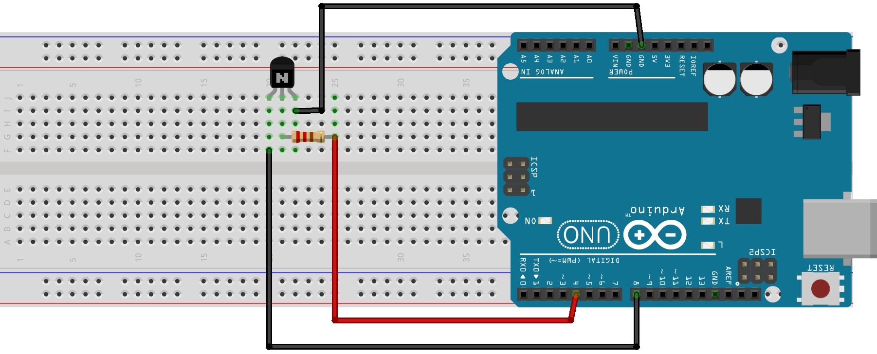

Hi, I'm using a numbered list, so you can refer to that number.
  1. The emitter should be connected to GND and the collector to pin 8. A resistor of 220 Ω will work, but you better use 1k or 10k. Please show us a photo of the transistor and the wiring after fixing it.
  2. Change "EmitterPin" to "CollectorPin" in the sketch.
  3. A millis-timer with different on and off times should have just one previousMillis = currentMillis. I prefer to solve the different times inside the millis-timer. An example is my millis_different_on_and_off_times.ino. Can you fix that in Pulse_Send() ? I suggest you make a small test-sketch and test it with a led.
  4. The EmitterPin variable is the number 8. It is never HIGH or LOW. Have another look at the Blink Without Delay example. Fix your Pulse_Read() to do something every second and use digitalRead() to read the input pin.
  5. Show us the new sketch.

Updated hardware layout:
Hopefully I am understanding properly your instructions.

Where is your pullup resistor? A transistor can not work without collector resistor. You should use either external resistor from collector to 5V or internal input pullup resistor by
pinMode(CollectorPin, INPUT_PULLUP);
Exactly what is your code trying to do?
As I see it, you pulse the base, LOW..HIGH..LOW. THEN look at the collector to see if the pulse appears.
That code will not see the collector pulse, it has happened while you were pulsing the base.
To try and do what you are is not possible with sequential logic.
A scope would be the way for you to measure the pulse response of the BJT.
NO!
When there is base current that connection of a transistor can cause a very high current through the transistor, blowing it up and possibly damaging the power supply.
YES you are right!. If the collector is directly connected to Vcc without any current-limiting "thing" LED, resistor, relay-coil or whatever this is a shortcut.
It has to be connected like that
for NPN-transistors
Emitter to GND collector to a resistor (or any other load)
My description was too short I wanted to say it is very unusal to connect
emitter and collector to IO-pins.
here is the video that shows the basic principle
best regards Stefan
Your PulseSend() is not okay. The combination of millis() with "if .. else if ..." does not work. Have you tested my example in the Wokwi simulation ? Have you made a small test-sketch to blink a led with different on and off times ?

Please post an image of your actual hardware. Frequently on this forum, we see a difference between a plan and an execution.
* Components: Breadboard; Arduino UNO R3; 2N3904 Transistor; 10K Resistor; Jump wires.
* Digital Pin 4 from Arduino connected to 10K Resistor
* 10K resistor connected to Base Pin of 2N3904 Transistor
* Emitter Pin of 2N3904 Transistor connected to Arduino Ground Pin
* Collector Pin of 2N3904 Transistor connected to Pin 8 of Arduino

You are saying that you connected an I/O pin directly to 5V or ground... that can destroy the pin.
I don't have a pinout for your transistor (a major problem already with your Fritzing, it's unlabeled), but assuming it goes ECB from left to right, you are driving the base directly from an I/O pin (a big no-no) and your collector is not connected to anything except an I/O pin. I don't see how it would be possible to test a transistor at all this way. There is no signal feed back to the Arduino because although you can bias the collector using the I/O pin, you can't simultaneously measure the current there.
Pay special attention to reply #13.
