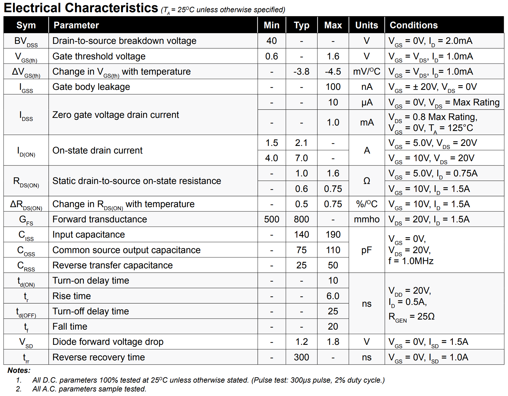

MOSFETs
Agreed with the first statement, but the "output characteristics" curve of the TN0604 tells a very different story. That doesn't look like a suitable part for OP, unless they switch less than about 200 mA in which case a BJT may be the better solution. Also its on resistance of 0.5-1 Ohm is quite high by current standards.

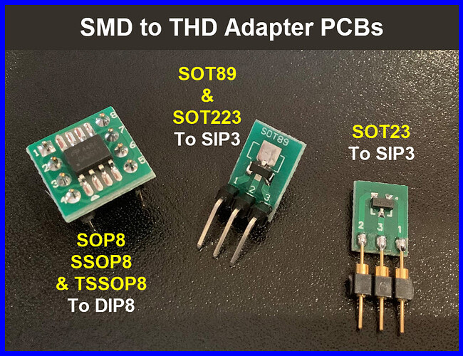

What you will find in TO92 package are old and very old designs. No modern designs are put in that package it seems, it's all TO-220 (very easy to hand solder) and SMD packages like the easy to hand solder SOT89 and SOT223, and the smaller SOT-23. The latter is also not too hard to hand solder with proper tools - they also fit beautifully in between three holes of a piece of 2.54mm pitch perfboard.

Thank you for pointing out these details. To be honest my soldering skill is not that great, hence why I prefer a package type that can be easily hand soldered on a perfboard. I feel comfortable with TO-220/TO-92, I am not ready to handle SMD packages yet.

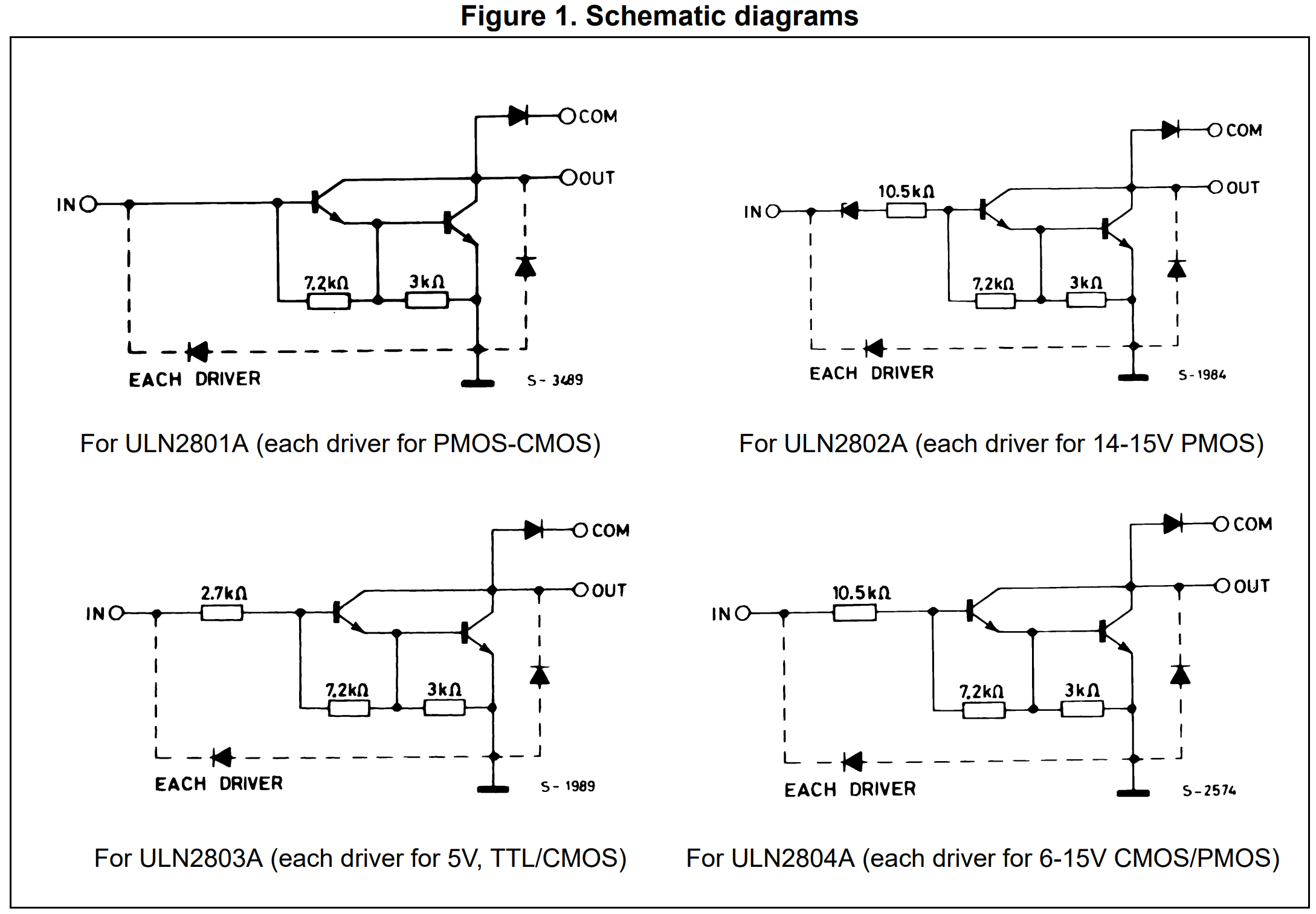

If you decide to use bipolar transistors, it might be worth looking into digital bipolar transistors. These types of transistors work like electronic switches and have built-in resistors. If you need to use more transistors, look at transistor array chips - the ULN2803 is such an array with 8 transistors, but it's for 5 volt logic. Maybe the ULN2801 is suitable for 3.3 volt logic, but I'm not sure. Let the more knowledgeable have their say.
https://www.st.com/resource/en/datasheet/uln2801a.pdf
That are darlington transistors. Those are much better replaced by a power MOSFET.

I found a list of equivalent for TN0604.
Is 2SK2851 a better choice over TN0604 with respect to lower RDS(on)?
Thank you.
Looks like a very useful one to me.
Just compare the "output characteristics" charts of the 2SK2851 and the TN0604. You see how at 3.5V you're fully on - the graph goes up and up. So it's good for a 5V circuit, not very suited for a 3.3V circuit.

Looking at the datasheet for 2N7000, I think I should be able to use it for the scenario described in the my first post. Assuming VGS would be less than 3V, 2N7000 should be able to handle 10-15mA required for the solid state relay.
Please do correct me if I am wrong.
And if I have a higher current requirement, I will stick to the beefier IRLZ44N.
Maximum VGS, TH is 3V so it may or may not work.
I'd suggest using a BJT (BC547 or equivalent) for this specific job.
