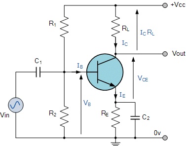

If you want to make an amplifier, that is a linear amplifier that you want to adjust the gain.
Then you need a different configuration that works with some independence on the actual BJT Hfe.
Such as this AC amplifier;
amp5
And this is the tutorial;
https://www.electronics-tutorials.ws/amplifier/amp_2.html

hfe is the AC gain.
HFE is the DC gain.
But, I may have forgotten some course material from 45-50 years past.
