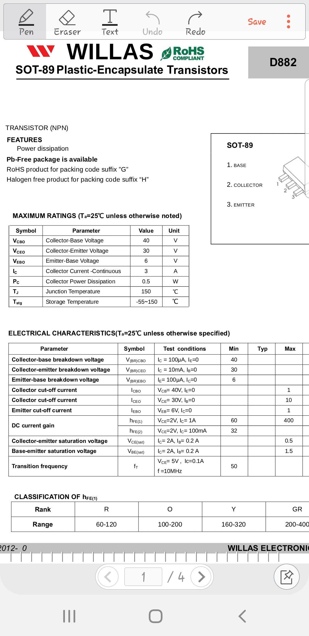

Here is the datasheet of the transistor im going to use.
Theories without practical approach really confuses me, I don't know if what i said makes any sense either. So summarizing everything i just said, i just wanna know how to find VCE and VBE in transistor datasheet so that i have all the variable to make the calculation.

Your datasheet says that the collector-emitter saturation voltage is no more than 0.5V at a collector current of 2A. The saturation voltage at other currents can be obtained from the Collector-emitter saturation voltage diagram in the datasheet or measured experimentally.
My opinion is that for a transistor in SOT-89 at a current of 2A, you need to think about heat sink.

A transistor amplifies the current so that the IC = IB * hFE. hFE depends on the letter of the transistor. D882R has hFE = 60-120, D882O has hFE = 100-200, D882Y has hFE = 160-320, etc.
You don't know exactly which hFE each specific transistor has. Therefore, the circuit should work if you have a transistor with the lowest hFE.
If you want IC = 2A, you must supply the base current sufficient that any transistor of the selected type will provide the required DC current gain. For example, for D882R transistor hFEmin = 60. If you need a collector current of 2A, you must provide a base current of at least 2000/60 = 33 mA or more.
VCE = 2V, IC = 1A indicates the conditions under which the DC current gain measurements were made. The transistor is a highly non-linear element. Under different conditions, we get different values of the hFE.

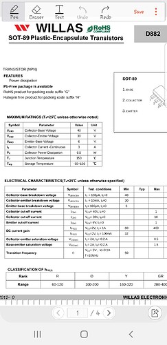

Ok, now I understand what the classification table is for. But then whats the purpose of the hFE diagram, if there are specific range of current gain for each letter, does that mean the diagram wouldn't help? This is the hFE diagram of the transistor anyway.

The ranking table says that out of all the transistors that were produced, the transistors with hFE = 60-100 received the letter A.
The hFE diagram shows that if we take an average transistor (with hFE β 240), then at average current values it has hFE β 240, at a current of 1A hFE β 200, and at a current of 2A hFE β 140.
You can measure hFE of your spesific transistor if you want.
You are right that based on your diagram, the voltage will be 70-80mV. However, another datasheet D882-R Datasheet shows slightly different values - about 180-200 mV.
Although this transistor is not familiar to me, in my opinion, in reality it will be more, about 200-300 mV.

Hfe is irrelevant when the transistor is in saturation (collector voltage lower than base voltage). The datasheet shows a 1:10 Ic:Ib ratio for saturation.
The datasheet shows a 1:10 Ib:Ic ratio for saturation.
