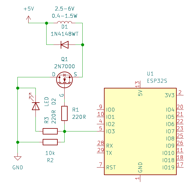

I am creating a circuit to turn on a small pump (2.5-6V, 0.4-1.5W) when an ESP32 pin is on HIGH, but I am having trouble getting the transistor to close the circuit. I’ve tried two different transistors (2N7000 N-Type MOSFET and 2N2222 N-type BJT) and both seem to have the same issue. When applying 3.3v from an ESP32 board pin to the gate/base of the transistor, the LED lights up, but the gate does not open. However, when I apply the 5v using a jumper wire to the gate/base, it opens and the pump turns on.
Looking at the data sheets for both of these transistors (linked above), 3.3v appears to be over the threshold/saturation voltage, so I’m not sure why the transistor is opening with the 5v but not the 3.3v. What am I missing?
FYI - The LED is only in there so I can see when the pin is on HIGH. I’ve tried running it without the LED and get the same results.

Try turning your N-FET around so the Source goes to 0V/Gnd
Typical N-MOSFET low-side switch wiring looks like this :
2N7000 is a very poor choice for motor control, as the absolute maximum drain current is just 200 mA. The 2N2222 NPN is not much better, with absolute maximum collector current 600 mA.
If using a BJT such as the 2N2222 the emitter goes to ground, and the base needs a current limiting resistor on it, say 220 ohms.
In your circuit R2 (10k) is only needed for a MOSFET, you can omit it for a BJT.
Oops - my diagram was wrong, I do have the source side connected to gnd.
The 2N7000 is not logic level. Vgs(th) could be 3volt.
One batch might work with 3.3volt logic, another batch might not.
Driving the LED from the same ESP pin will drag drive voltage down.
Leo..

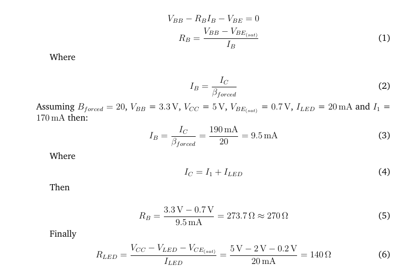

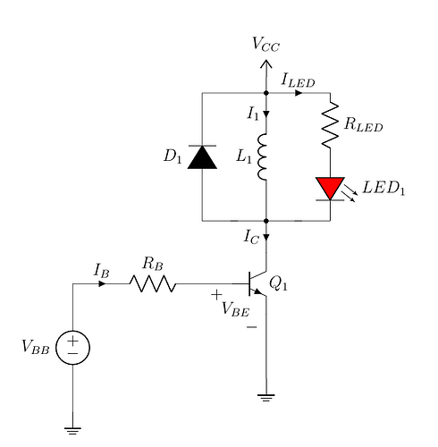

If you are planning to use a BJT transitor, maybe you can try with this circuit

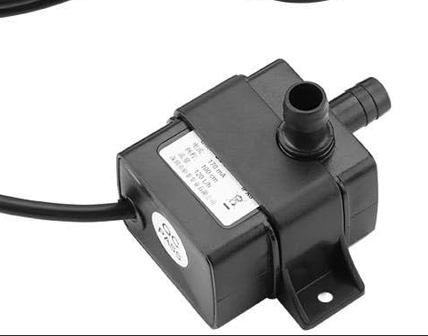

Note 1: I don’t know the current of your pump, I found in internet this one. I can almost swear it says 170 mA, which is why I used that value for the calculations. It is up to you to use the actual values of your components.
Note 2: Note that the base current is somewhat high, this is the current that your microcontroller pin will supply. It is important that you look at the datasheet of your uC for the current characteristics of each pin. Maybe you can try another configuration

20ma is the absolute max current rating for most small LEDs.
I know it. This is just an example for the thread starter of how to do the calculations. And thanks for the observation
Just use the standard 220 Ohm as base resistor.
It is always important to know the calculations, not just put random values. The lower the value of the base resistor, the more current the microcontroller pin will supply.
Hi, @kglidden423
Welcome to the forum.
A good schematic mate.
I've edited it to the usual layout, input to output, left to right, power top, gnd bottom.
