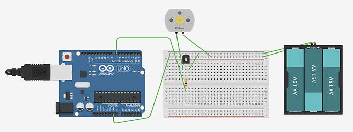

Hi all,
I am using a 5V power supply, a NPN transistor, a Arduino and a 3-6 volt motor and my circuit will not work. I have tried many different configurations and they all won’t work. Here is a picture:
The red and brown wires extending off the screen go to a 5V battery.

From the looks of it you have it the wrong way around, but that is just from the looks of it.
Try swapping the yellow & black wires that are connected to the transistor, and please add the flyback diode (cathode to the Green on the motor id' say)

This is almost completely identical as what I have (after switching the black and yellow wires on my breadboard). The only difference is the batteries equal 4.5 V and not 5V. My transistor is the MPS2222A. TinkerCAD says it should be working, but it isn’t.
Edit: forgot to mention the resistor is 10000 ohms
With a 10k base resistor...?? I doubt it too.

The transistor needs at least about 1/20 of the motorcurrent into the base.
Make that 10k resistor about 50x smaller. Try 220 ohm.
It seems connected the wrong way round.

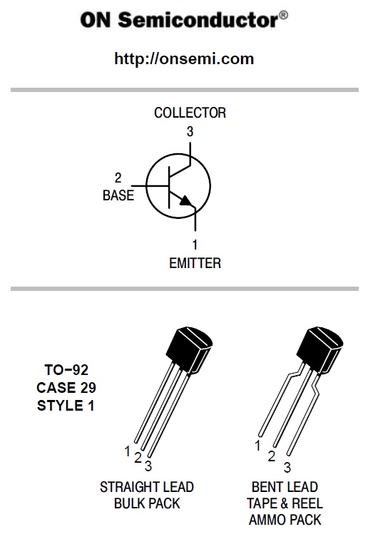

Check the MPS2222A datasheet.
Emitter should be connected to ground.
That diode on the table should be across the motor, to protect the transistor.

Maybe OP used a 2N2222 instead of an MPS2222.
They have a different pinout.

Switch to a 1K resistor first up. (10K should probably also work, but the datasheet mentions 1K)
  • Connect the motor directly to the PSU to verify it still works, and measure the current draw with a DMM
  • Grab another 1K resistor and put it in place of the motor.
  • Instead of driving the transistor from the UNO, connect the resistor at the Base of the transistor to 5v+ of the PSU and see what the voltage reads at the collector to verify that the transistor works.
  • If it still does connect it again to the UNO and see if that still works.
The answer to the problem should become clear to you after this.
Bullet three will kill the transistor...
The base resistor (other end) should be connected to +.

Have you checked the E, B, C pinouts of the MPS2222A?
That is what it says.
Sorry, you are right...
