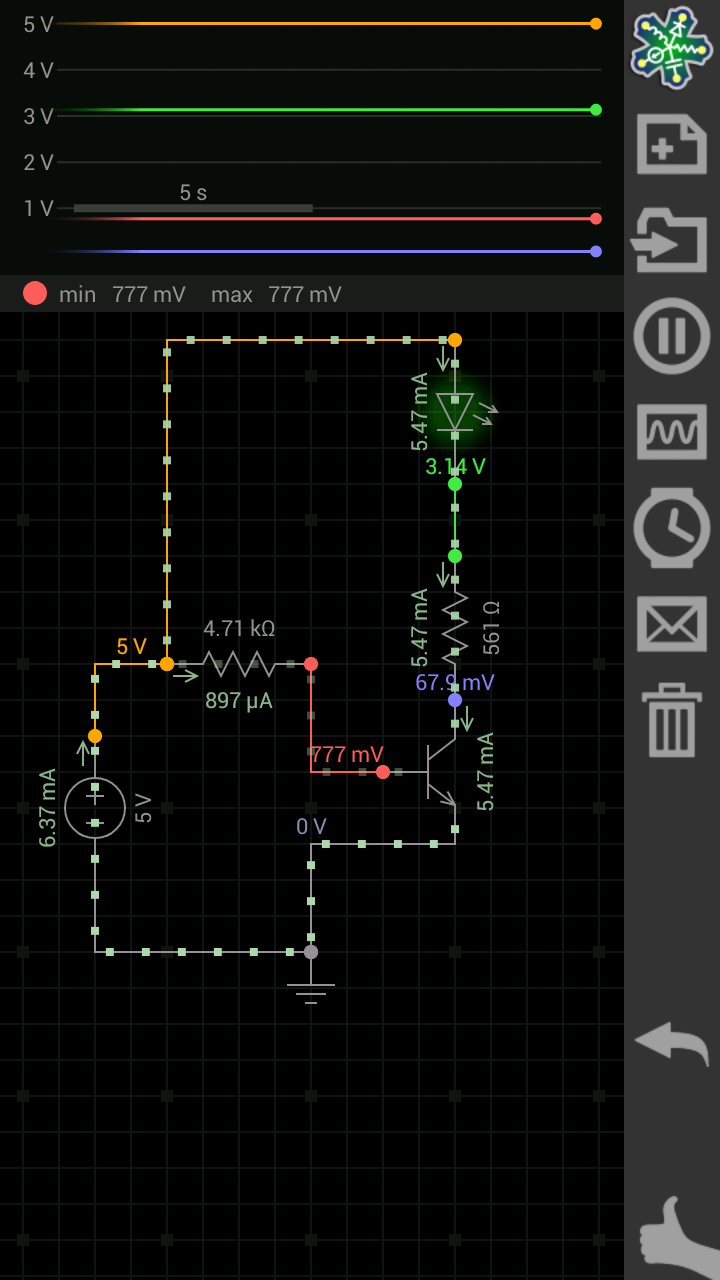

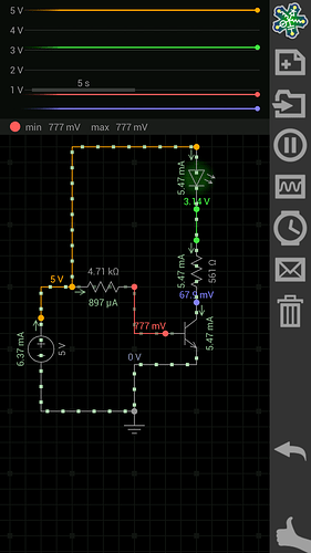

So I set up a test:
The LED had a forward voltage of 1.71 V.
The transistor had a Vbe of 0.872
The theoretical current through R1 would be:
(5 - 0.872) / 4700 = 0.000878 (0.878 mA)
Measured was 0.857 mA, so that is reasonably close.
The theoretical current through R2 would be:
(12 - 1.71) / 560 = 0.018375 (18.38 mA)
Measured was 18.57 mA, so that is pretty close.
I measured 12.06 V at the +12 V point, and 10.28 at point C, giving a voltage drop of 1.78 V in circuit.
I measured 60 mV at point D, so it would appear that the collector/emitter voltage drop was closer to 0.1V than 1.6V.
I measured 19.20 mA at point E, so that would be roughly the collector/emitter current plus the base/emitter current.
Does all that sound right? And does that make this quote incorrect?
If the transistor is on, the Collector voltage is 1.6 volts higher than the Emitter voltage.
