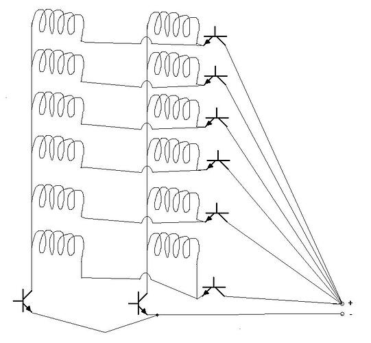

Here is what I have done
Could you tell me how I can efficiently and safely connect this to arduino ?
There is no way in the current universe of the laws of physics that that circuit can do anything.
Can you say again what you are hoping to do and why.
I have 12 coils which I need to switch on and off with 8 transistors.
Two of the transistors (when switched on) connect six coils each with the negative pole of the power supply. The rest 6 transistors control two coils (one of the first six and another of the second six) and when switched on they connect these two coils with the positive pole.

It might help if you say why you think you want to do this. You are dealing with a micro controller so if each coil is connected to a transistor you can turn any combination of coils on at any time. What advantage do you see in this seemingly complex arrangement?

It is a bit confusing I know but it might help if you take another look at my schematic.

- I cannot spare more than 8 pwm pins(cannot do it with digital and all the analog pins are in use)

so what is the voltage you are trying to drive the coils with, you will not get more than 4.3V on the output of the top switching transistor if it is NPN.
So we know you are trying to PWM the coils but why, and to what end and why will this arrangement be any advantage to you?

I have 12 coils which I need to switch on and off whenever I need and they are connected to a 19V power supply. In order to do this I am using transistors. Unfortunately I can use only 8 transistors because there is no more room and I have only 8 pwm pins left (there are no more pins of any type to drive the transistors). I have come up with a more complex arrangment to drive those 12 coils with 8 transistors but from what I have seen and what you have told me, it does not work.
Given the above situation I hope you could tell me how (if there is a way) I could fix my circuit or how else to arrange it in order to work.

A power of 19V at a resistance of 3.8R gives you 5 Amps per coil.
