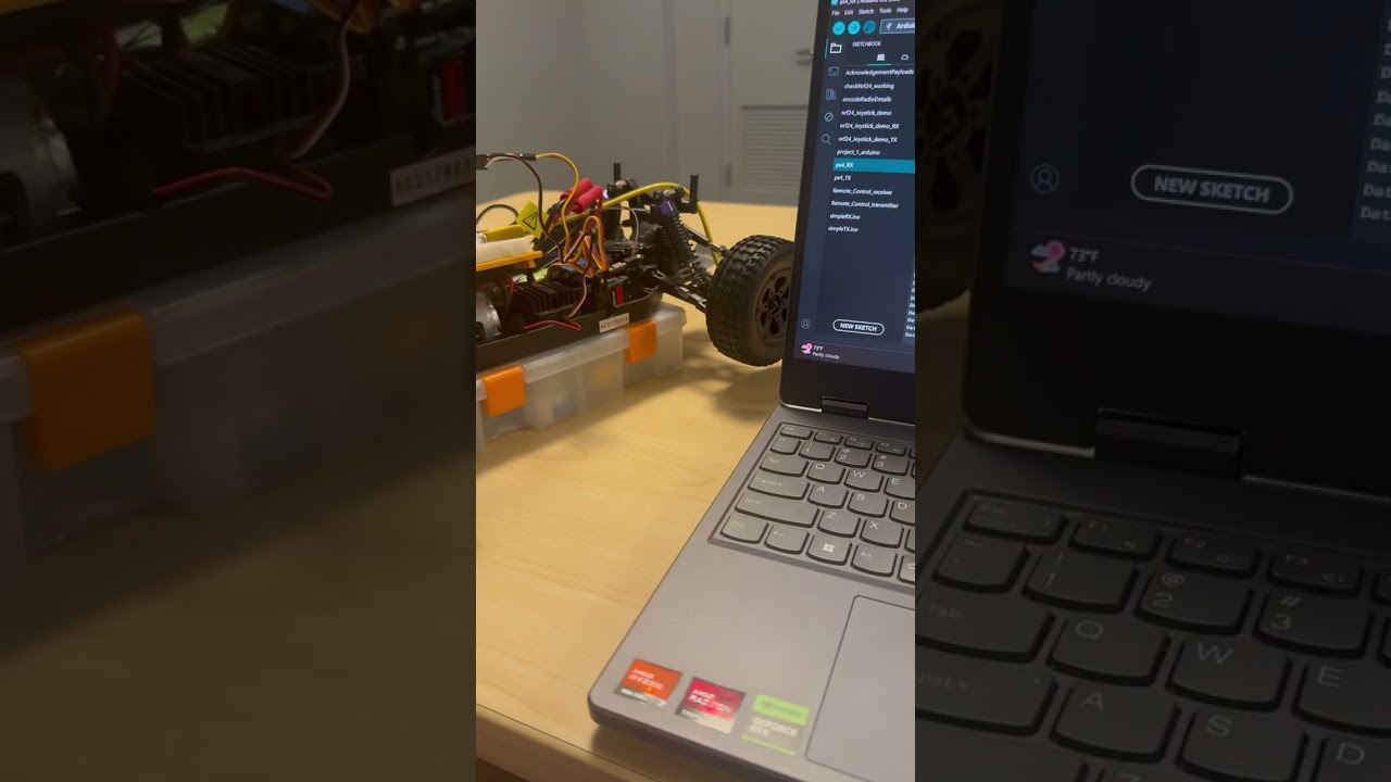

Transmission finally works now, but the rc car keeps glitching(ps4 nrf24)
I'm using a ps4 controller, 2 Arduinos connected to 2 nrf24, & an rc car. The analog transmission works, but the rc car keeps lagging when receiving the inputs, any way to resolve the issue?
Video of the issue:
note:
the tx pins (CE, CSN) are (7,8) to accomodate the usb host shield
I have connected an external power supply to the rc arduino
the rc car has a brushed motor, i dont know if that plays much of a factor though as i dont know much about rc cars.

thanks for your help, unfortunately, commenting out the serial monitor did not work.
I uploaded a video of the issue just now on yt, the link is here; https://youtube.com/shorts/iDczsgIsbqE?si=KdMvGriiqNtPxj_P
Why do you have the same mapping on sender and receiver side?
If the radio is not available for a very short period, the turn and ESC will be set to 90.
Maybe you should only go to this default setting if the radio is unavailable for 0.1 sec or so...

Thank you, the car finally works. It finally works! It’s been so long since I’ve been working on this project, just check my profile. All the usb host shields that I used, radios that I tried to get working, the coding classes I took. It was all worth it. Thank you, because of you, this project finally works. Ur my hero man.
Best, Aperson8484
Glad you got it working!
What was the essential fix?
Looking at the code it would have been the "else" in his loop
If radio.available would only trigger say 60 times a second (or whatever his send rate is)
So everytime that fails (lets say 1000 times a second) it jumps to setting the servo and esc to 90.
So 99% of the time servo and esc would be set to 90. Then there would be brief pulses where it chances when a packet comes through
Just getting rid of the “else” loop & that was it.
Wow you got it spot on, that’s exactly what happened during testing.
