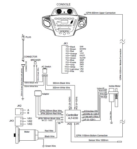

Latest update.

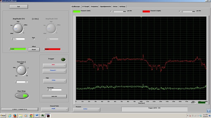

Got a 10000 ohm resistor tied in with a diode and am getting a 60 hz signal, but I cant really tell how to read the PWM yet.
I have included the pictures of the schematics below.
I would greatly appreciate anyones assistance in figuring out how to use the Arduino to replicate this signal.
On JK1 there are 12 pins. Of interest to me are pins 5&6 or Fast/Slow
in the picture Schematic 3 I have a close up of JK1 and the pins and their wiring. Schematic 1 is the whole board.
Using Schematic 3 if you follow pins 5&6 it shows how it is connected. In schematic 1 it shows another branch of it that I do not understand. I am assuming that signal goes to an IC
JK2 is the reed switch which I might also use later, most likely will need it for displaying speed.
After looking over the schematics for a few hours, I've run into the conclusion that there is probably more than just PWM signals being sent.
PIC12F508 is a micro controller but I do know that the signal from the GP2 goes to the opto which goes to the other Microcontroller (if it wasnt complicated enough). The Fast pin goes to GP4, and Slow goes to GP5 and again everything coming out which is likely serial data of somekind goes out of GP2 which activates the PWM Led on the board which then goes to the Voltage IN on the ALT-633060A Microprocesor/controller which controls the PWM signal that goes to the transistors that control the motor. So I either need to interpret the PWM out going to the motor, or interpret the data coming out of the GP2 from 12F508 which I imagine... I cannot do since I am a newb at all of this.

I bought some shielded cable today to go ahead and try the oscilloscope again on that wire. (that 60hz that I was getting I believe to be the power cord that the wire was near, which means I didnt really get any important data). Can the arduino in anyway capture data from the Fast and Slow pins? I believe it to be data rather than a PWM signal because they both feed into pins on an IC which then outputs a signal to a LED --> then opto coupler --> Microcontroller --> PWM output to the motor via transistors NPN and PNP interaction with the mosfets.

I set the Frequency at 89hz based on my oscope readings
and I am using shielded cables to protect it from interference.

12/25/18 - Ok, here’s my treadmill project....... The details may provide some insight - I have a Spirit Esprit ET-8 Treadmill, and the top board that runs the console is fried. The bottom board: https://www.amazon.com/Sole-Fitness-Controller-Transformer-Treadmill/dp/B07K5K1YK9 - that controls the belt speed and incline works just fine.
There’s a 12 pin cable that runs from the lower board up to the upper board console. Coincidentally, and what I expect is fairly typical, the pin layout referenced in this thread above is identical to the pin layout of the 12 pin cable in my treadmill and may be similar or identical to what you have:

Now, to control the treadmill - jump 1 and 4 together for power. Then A) Make Break 5 and 7 over and over to increase speed in .1 mph increments. B) Make Break 6 and 7 over and over to decrease speed by .1 mph increments. C) Make 3 and 4 together to incline the treadmill. D) Make 2 and 4 to decline the treadmill.
I have put 4 push buttons on the treadmill console that perform those four A-D functions.
Now, I’m going to do that A-D with Arduino Uno along with adding additional functions. Instead of speed increments/decrement of .1 mph, I’ll make that .5 mph. Also, will add 5 buttons to take speed right to 2, 4, 6, 8, 10 mph. Will also add 7 segment leds to display speed and incline amount.
I’ll post more as this progresses, but hopefully, there’s something here you may be able to move forward with.
12/26/18 - One note from reading through the thread - a pot is not used for any of above. Just Make Break the circuit of pins 5-7 to increase speed, and Make Break the circuit of pins 6-7 to decrease speed. The intro arduino push button solution for that is pretty basic. Connect pins 1 and 4 to the magnetic emergency switch of the treadmill.
I believe that pins 8 and 9 are used for pwm speed control. In normal operation, this is how speed would be adjusted, and pins 5 and 6 would be used internally by treadmill to adjust speed in small increments when magnetic belt sensor reading does not match user selected speed. I will need to test in a day or so.
