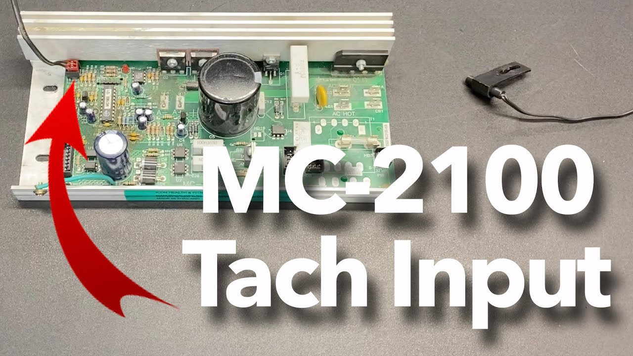

What treadmill controller do you have?
If your lucky that would be a mc-2100 if so I have code and much info about that particular one.
EDIT: I missed that you do have the mc-2100.
That's a good controller and you do not need the pwm signal generator the arduino can handle it just fine and with 5300 steps of resolution between 0-85% power.

This code produces the 20hz PWM signal required by the MC-2100. By manipulating the Arduino timers directly we can achieve the 5300 steps of resolution.
Because the 2100 has closed loop feedback (has provision for tach input) this code is limited to 85% max dutycycle. This allows the closed loop circuit to attempt to maintain the RPM under load. I recommend using the Tach Input as it's not hard:
This test code uses a potentiometer for the getDutyCycle() function. So it is only capable of 10bit(1024 steps) resolution because it is constrained by analogRead(). A keypad will not be so constrained.
However the applyDutyCycle() function can handle any number from 0 - 5300 steps of resolution. Just remember that the motor will not start moving till around ~15-20% dutycycle.
And yes you can limit the speed to anything you like in the code.

I would like to add that it is possible to read the Tach Input directly from the MC-2100. I just never got around to implementing that feature. But I would be willing to work on that if you want to test it for me.
Thank you very much Hutkikz . I will be spending some time trying to learn how/what the code does . I watched pretty much all DazeCars youtubes on Treadmill's & controllers . I do have the reed switch for the tach on the MC-2100 hooked up reading the pulley on my motor for now . From the reading I have done on the MC-2100 I understand that the onboard tach act's as feedback to keep the motor at set speed under load . So my thought was that if I'm cutting & start to bog the motor down the tach will tell the motor that it has slowed down some & bring it back to set speed . Am I understanding that part right ? So your saying that the arduino can read the tach from the 2100 ? I thought that I was going to need a seperate tach . That sounds interesting . So I'm still trying to figure out where the " 0 - 5300 steps of resolution " comes from . I do get the motor not starting till around 15-20% duty cycle & the 85 % max part . Sounds like you've spent some time with these MC-2100's . I have a MC-60 & a MC-40 which both work with just a pot , but I have other plans for those motor's & controllers .

Since Your already familiar. The info I was referring to was the fact that on his original treadmill the reed switch was not on the motor pulley but on the driven pulley that runs 50% slower than the motor pulley. I confirmed this on my own treadmill.
This means the board expects a Tach signal that is 50% of motor speed!
Now I am not sure if that means anything. The Sons of Inventions guy thought it was what was causing the issues he was having at the time tho I am not sure I agree. On my drill press I planned to build a circuit to emulate that but in 8 yrs it never happened and having the reed switch on the motor pulley worked as well as Dazecar's But you can see on his video that it has a bit of lag to it as did mine. I keep thinking that if it was getting the signal as originally designed it might not lag so much.
OK , I missed that part , but my plan is/was to have my tach pickup on the actual spindle . On all the TM's I've salvaged the pickup was mounted on the driven/large pulley . I kinda lucked out when I started getting my hands on TM's cause 3 had MC-2100 , then a MC-60 & a MC 40 . I also got my hands on a commercial TM & that guy came with a awesome motor , unfortunately there is no reverse engineering anywhere on the controller for that motor . A guy that used to repair TM's told me that that was the best motor a guy could get his hands on for a lathe or a mill . Also fortunately the motors off the MC-2100 TM's have a separate fan so I don't have to worry about cooling after I pull the flywheel /fan off . I still plan to use a seperate computer fan for cooling , just to be on the safe side . Unfortunately I lost the chokes & 2 of the reed switches , so I will have to get those at some point .
