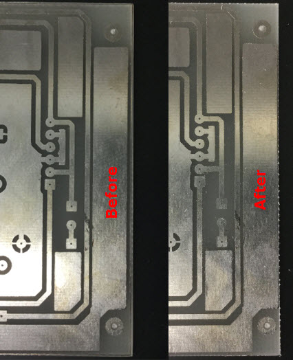

Here is an idea showing how to make professional trimming jobs.
You can remove fractions of an inch from: PCBs, Front Panels etc.
Also square things off.

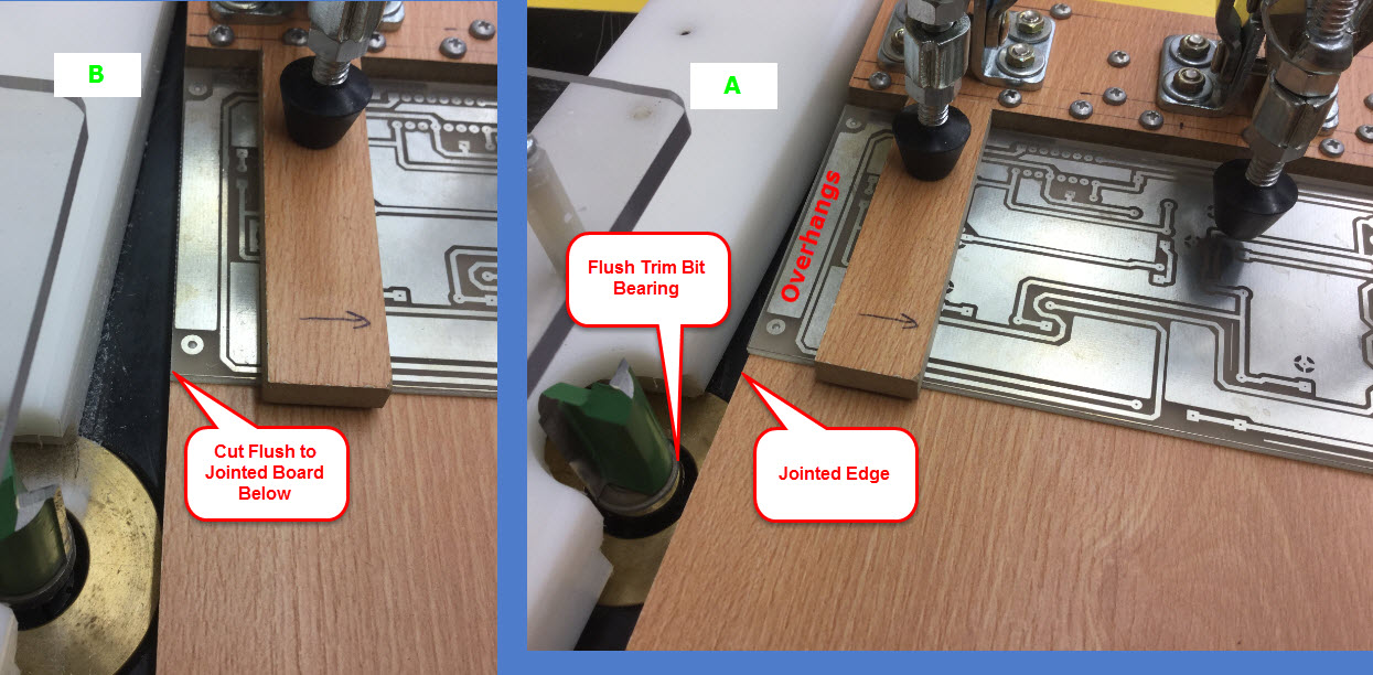

I made the jig using toggle clamps and floor hardboard.
How long do your bits stay sharp?
I use carbide bits in my router.
I am on my second flush cut bit (in three years).
I use this jig for: PCB glass board, acrylic plastic and wood projects.

A router and a flush cut bit with the toggle jig allows you to cut/trim fractions of an inch up to about 1/4".
