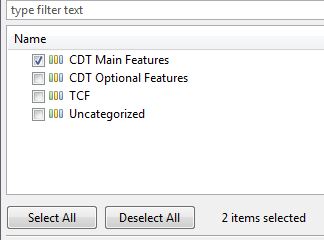

So i want to do my Arduino programing in eclipse and I am having trouble installing the C/C++ enviorment. I am also a webmaster so I use the Java EE install of eclipse to open my website file threw my FTP to make small tweaks in my word press blog. The main thing that sold me on Eclipse was the Fact that I would not have to fool with multiple IDE for different applications. When I attempted to download the C/C++ plugins per CDT Downloads | The Eclipse Foundation with "CDT 8.0.2 for Eclipse Indigo" link as I am using Indigo. I ran into allot of install errors. Only the CDT main features would install smoothly. So to my Final question is do i need the CDT options, TCF, And Uncategorized plugins for the AVR plugin to work Plugin Download - AVR-Eclipse.

I see it was not clear from my post that i understand the “perspectives” concept of Eclipse. The C/C++ perspective works just fine its the extras that did not install let me show you with a picture. This first picture shows the IDE running the plugin I installed. The second photo with the checked box shows the only part of plugin package that would install without faults. Dose the AVR plugin require any of the “CDT Optional Features” , “TCF” , or “uncategorized” portions to function. Also dose your plugin require any of these portions of the plugin to function. I am taking extra care to not screw up my IDE because I am so green to all this it could be clearly malfunctioning and i would never know. I have also heard that eclipse is a bear to repair once broken.
