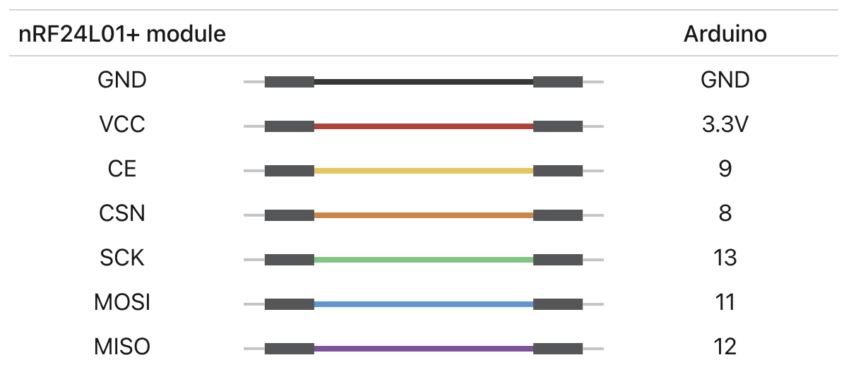

Is having all the wires overlapping causing issues? When these are active the have been from 30cm to 1m apart with no change (although sometimes the outputs from the receiver change in frequency based on where I am standing near).
I have used the wiring suggestions from Last Minute Engineers
As evident I have also soldered a 10uF capacitor on the ground and vcc pins of each transceiver. I am both hoping and assuming that the modules work.
What should I do to make these work? I have heard about wrapping ground wires around some of the wires but am not sure which ones or how to do that. Any help would be greatly appreciatedd

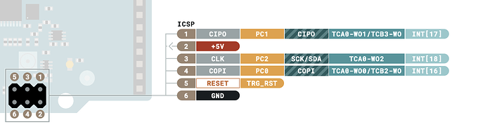

Be aware that on an Arduino WiFi Rev2, the SPI pins are not available on pins 11/12/13 but on the six pin header.

What you are seeing is not that uncommon. Use a seperate 3V3 power supply that is well bypassed. Powering it from the Arduino is sometimes maybe proposition. It generates current spikes that require more current then the arduino is capable of supplying. Sometimes caps will help then later they may fail working.
Thank you for this, I now recall reading this at some point
Are the nRF24L01's plugged into little adapter boards? Do they have an AMS1117 5v to 3v3 regulator on them? If so, you need to apply 5v, not 3v3.
Make sure your ce and csn pins are the right way around (some modules label them CE = CNS and CSN = CE or something like that from memory) try and switch them
You can try set the palevels on both too low
Try and half the spi rate in RF24_config.h file. Look for the line #define RF24_SPI_SPEED 10000000.
You can try without the adaptor board and use 3.3v from the arduino. Ive had a few dodgy boards of these in the past
Thank you all, the solution has turned out to be using the Arduino 5V output into the regulator board. Although I still need to work out making it work with the Uno WIFI, does anyone know if it as simple as connecting to the ICSP pins as outlined on the Arduino Pinout diagram? (so in this case MISO to ICSP 1, SCK to ICSP 3 and MOSI to ICSP pin 4?)
It should be but I don't have an Arduino WiFi Rev2 to play with.
