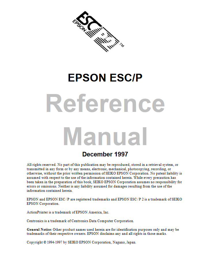

I can't remember a thing from dot-for-dot graphics on printers, but I do remember sending a lot of escape sequences...
from this document...
Setting the page format
ESC ( C Set page length in defined unit • — — C-10
ESC ( c Set page format • — — C-11
ESC C Set page length in lines • • • C-13
ESC C NUL Set page length in inches • • • C-15
ESC N Set bottom margin • • • C-17
ESC O Cancel bottom margin • • • C-19
ESC Q Set right margin • • • C-21
ESC l Set left margin • • • C-23
I will take a SWAG and suggest getting (download) an Epson printer manual from the late 90's through maybe 2010.
Thank you, ill try to implement this over the weekend!
That would certantly help, I even tried finding one, however this is the only one I could find.. while it covers certain things like page length, it doesn't margins and graphics..
And the esc/p2 reference doesn't provide many examples ether, so I am a bit lost on that too..

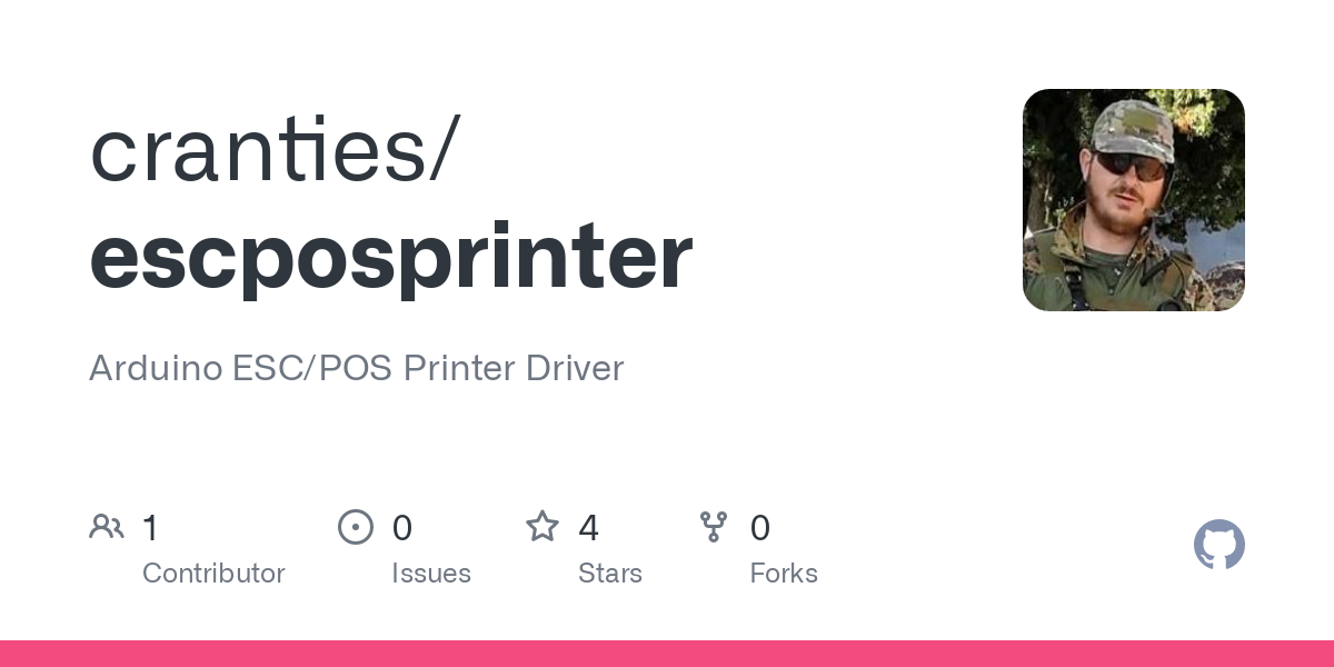

Hello Avionic_20
Take a view here:
hth
