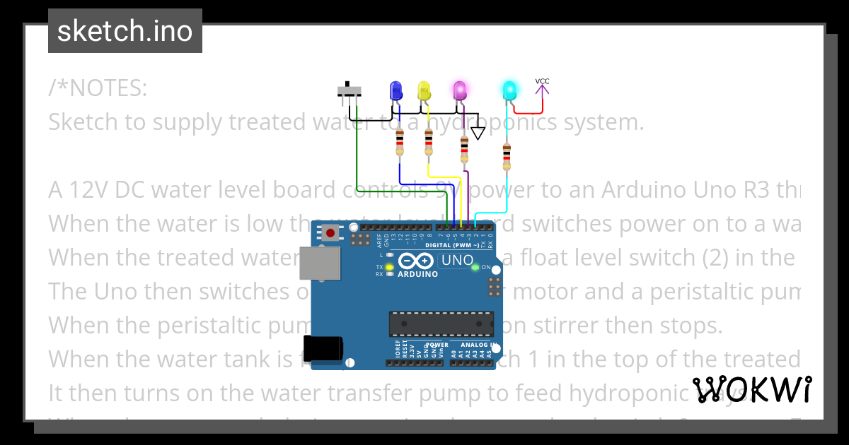

There is a simulation-website called WOKWI where you can simulate quite a lot of things.
I created a WokSim for your code.
The leds represent your motors and relay
Here is a simple version that has only constants for your IO-pins instead of numbers
