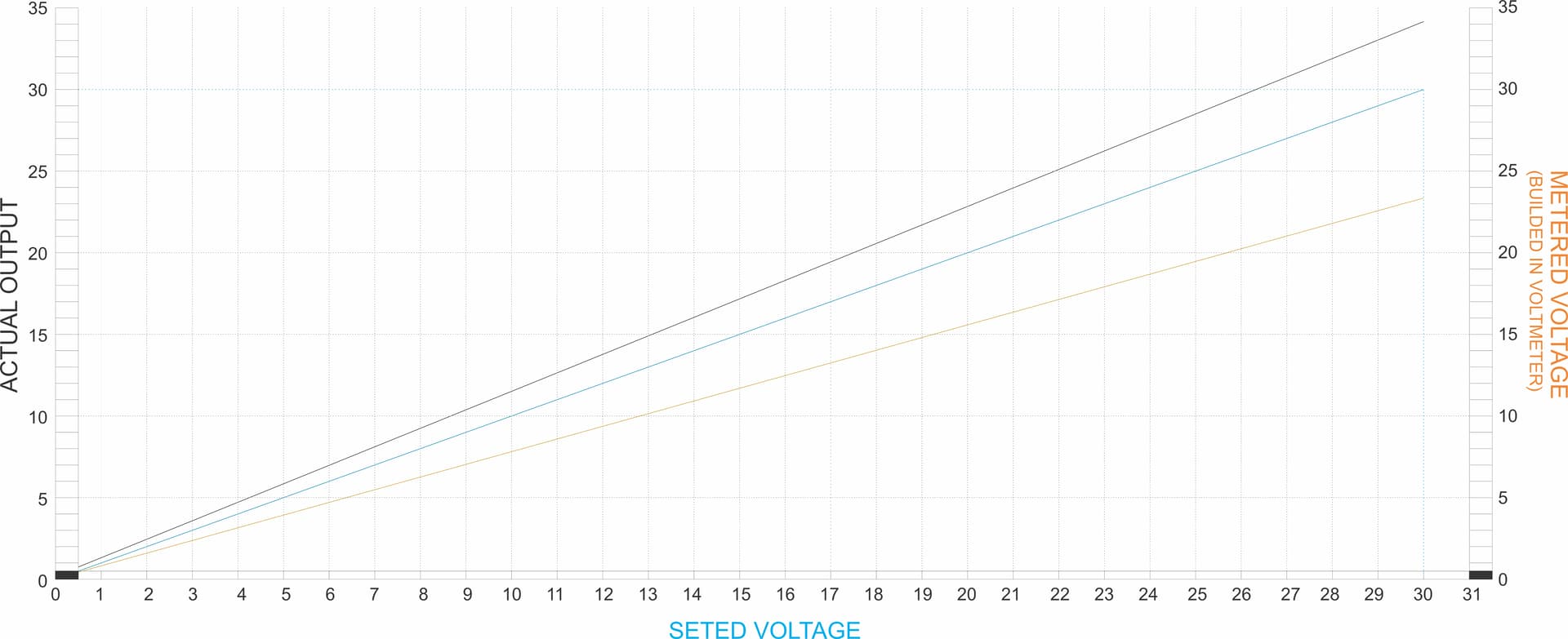

Example 1: in this set, the actual output can be over 30.00 seted volts, but "builted in voltmeter" measure 23.37V (SETED OUTPUT VOLTAGE FROM 00.50 TO 30.00v) linearity is not the problem...

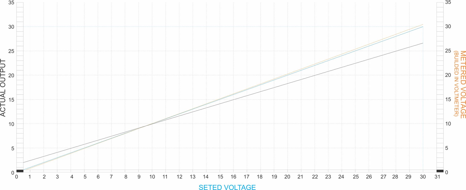

Example 2: Actual Output almos reach the desired condition (blue line) vrs "seted output Voltage", the "measured voltage" drops even more...
Sorry, I still don't understand. Is there an Arduino or similar involved? Show us the wiring diagram and the code in code tags.
Example 3: And can ocurre the oposite, the actual output drops, and the "metered voltage" can rise from the actual and seted voltage... the game is, "seted voltage, plays the (metered Voltage)", the calibration process plays the "metered voltage" and the actual output...
