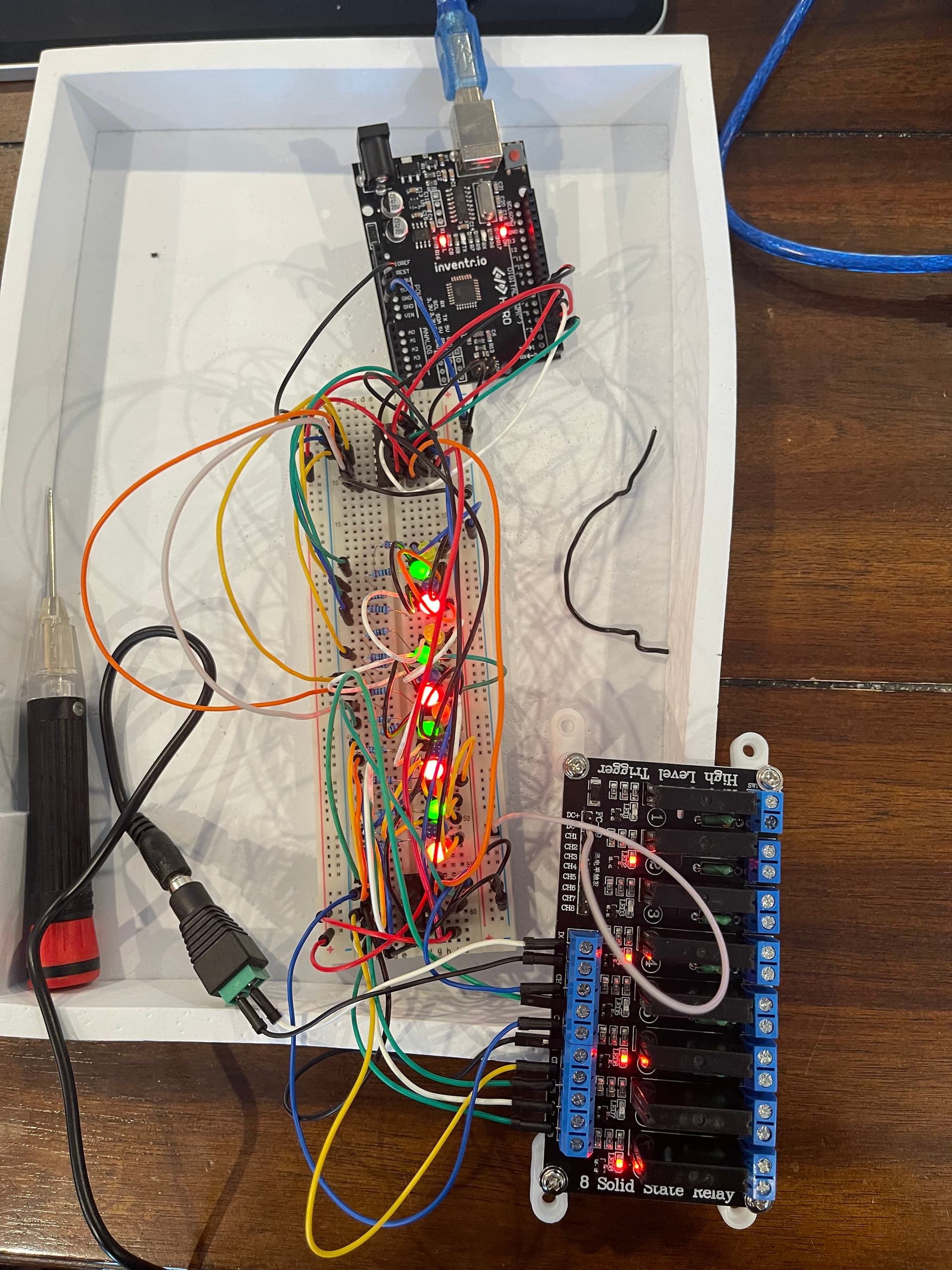

We are first time arduino users trying to use an Arduino Uno into shift registers into relays to power 16 Christmas lights. We are so close to having everything working but are getting flickering as the relays switch and trying to troubleshoot this piece. We believe the problem is with the relay or could be needing something to help with signal noise, but have gotten to the point where we are stuck.

Works on our LED test system and the LEDs on the relays are working as intended, but have extra blinks on the actual lights.

Arduino to proto board
IMG_5585
Protoboard to relays and relays to outlets
IMG_5586
IMG_5587
IMG_5588
Note we did ground the relays to the ardiuno ground as we weren't getting all 8 on a board to turn on without it.

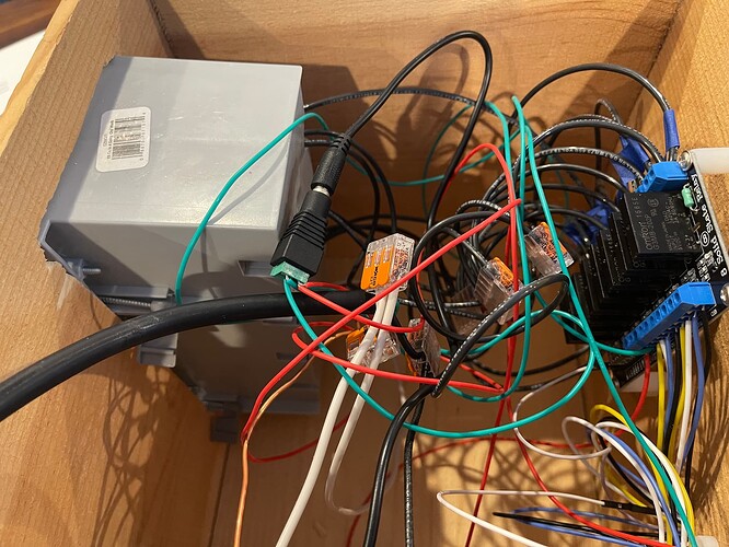

Outlets and power
IMG_5589
We use separate power for the arduino, relays, and outlets (this is all LED lights plugged into the outlets so running everything off our extension cord plugged into power)

  • Admire your efforts. :thinking:
  • Wires are very long and look a bit like a dog’s breakfast.
    Noise between wiring is a problem.
  • Cannot see decoupling on the switch register prototyping PCB.
    This needs to be corrected first thing. <β€”β€”β€”β€”β€”<<<<<

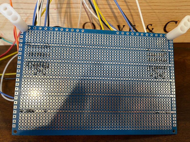

  • Show us the back of the register board.
  • A proper neat schematic showing all connections is needed for us to see if there are design problems.
You failed to identify the 5 volt power to the Arduino. I see there is a warning about the unknown voltage range for the relays: "0V - 0.5V Low stage (SSR is OFF), 0.5V - 2.5V (unknown state), 2.5V - 20V High state (SSR is ON); ". Your project is likely spending too much time in the unknown state!

Looks like a recipe for getting someone electrocuted...

We do not have any decoupling on the switch register. Looks like this may be the problem. It looks like we will need to buy some of those. 10nF size okay? And these would go between the VCC and GND pins for each shift register?
Here is a pic of the back of the board and a new schematic

  • Suggest you use 100nF ceramic capacitors; mount them as close as possible to each I.C. power pin.
  • Also, add a 100uF reservoir capacitor on the 5v line right where it connects to the prototyping PCB.
FIRST! determine that your project is spending too much time in the unknown state. Use an oscilloscope to monitor the signal.
  • We need to see a link to the relay board you are using.
  • There needs to be a proper reference point between the Arduino and this board.

Are you certain the flickering isn't a design feature of the outdoor lights you selected and that you are within the 2A limit of each SSR?

Update, we got capacitors and added one per each shift register connecting the VCC and Ground pins. We then tested it and we still had the flickering. We added in the capacitor to the 5v line prior to the PCB and tested again and still had the issue.
The Arduino isn't connected to the relay board directly. It all goes through the shift registers.
What for? Uno has more than 16 i/o pins.
We then decided to give this a try and go directly from the Arduino to the relay board. Pins 2 and 3 to switch 1 and 2 to test and see if that would solve things. It did even more strange flickering but was clearly on when it was supposed to be on, but it looks like the relay is stuck in an unknown state when not on. But I don't have an oscilloscope to measure. We connected up a multimeter and it is not switching cleanly off to 0.
At this point, I think we need different relay boards. Does anyone have a suggestion?
