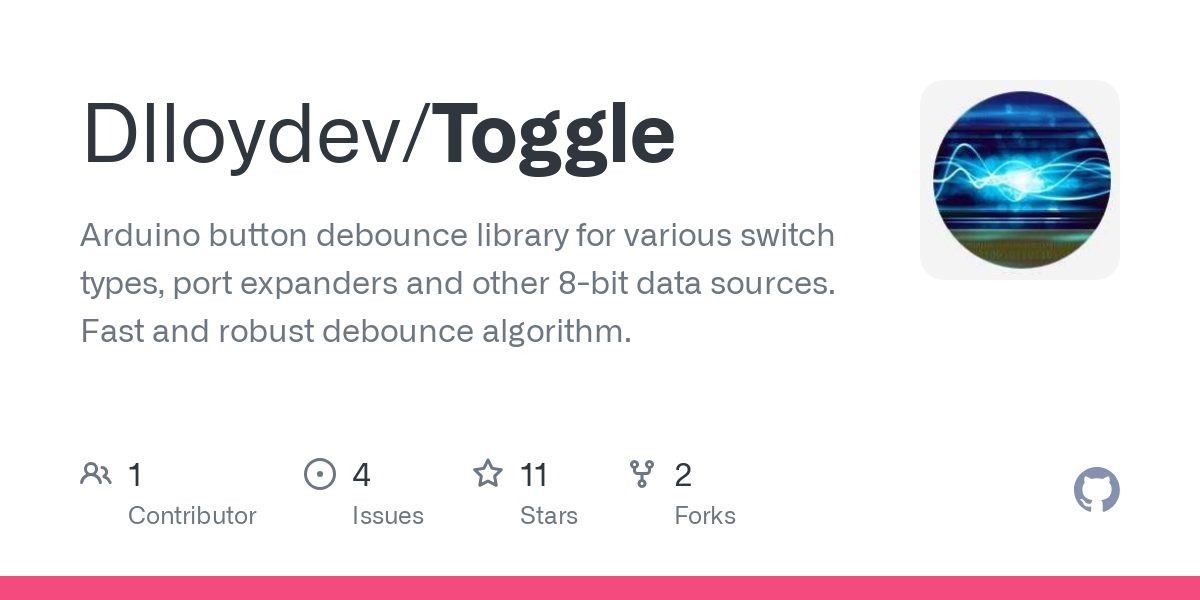

Thanks- here's the library link:
It claims a "fast and robust debounce algorithm."
Theoretically my thought was this would be easier to implement a few switches down the road then digital read. I'm pretty sure its looking for switch connecting the pin to Ground (there is a toggle in the library to switch it for pin to 5v but default appears be ground).
