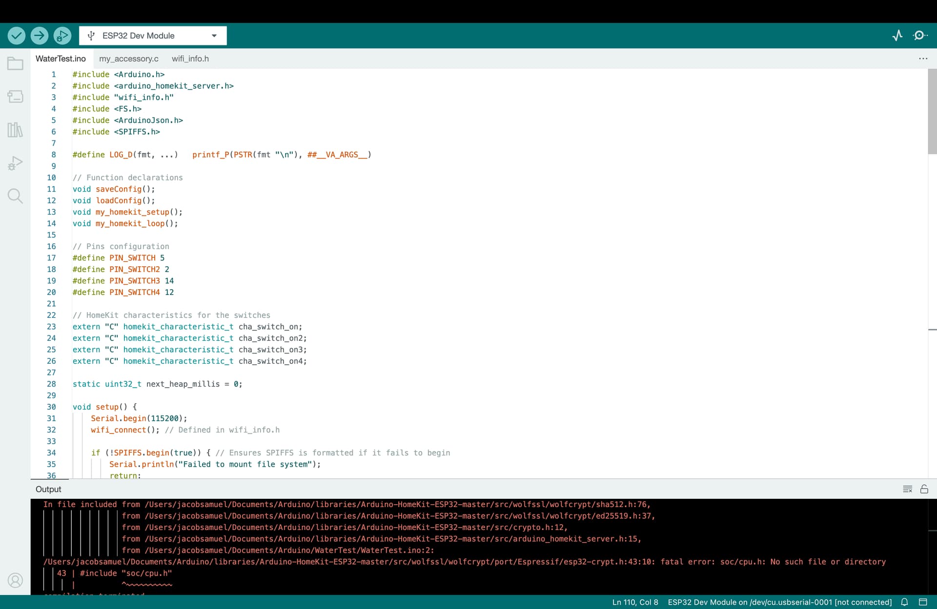

Hello, I’m working on a HomeKit Light Control project with an ESP32 board and coding in the Arduino IDE, but I’ve been facing persistent compilation errors for over a week. The main issue started with an error indicating “esp32-crypt.h” was missing (fatal error: soc/cpu.h: No such file or directory).
I attempted to resolve it by downloading esp32-crypt.h separately and adding it to my libraries, but this only led to further errors. After replacing the file from Google again, I encountered a new error:
error: 'WC_ESP32SHA' does not name a type
134 | WC_ESP32SHA ctx;

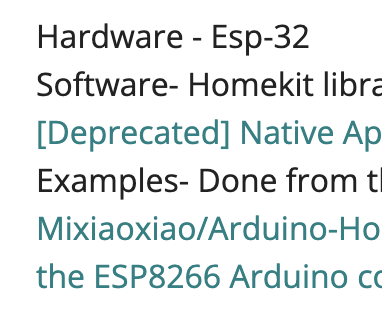

Hardware - Esp-32
Software- Homekit libraries by Mixiaoxiao’s(GitHub - Mixiaoxiao/Arduino-HomeKit-ESP32: [Deprecated] Native Apple HomeKit accessory implementation for the ESP32 Arduino core.)
Examples- Done from the Esp8266 Switch examples by Mixiaoxiao's(GitHub - Mixiaoxiao/Arduino-HomeKit-ESP8266: Native Apple HomeKit accessory implementation for the ESP8266 Arduino core.)

You are doing the wrong thing. If you are missing libraries, use the Library Manager to install the Library, do NOT grab random files from the internet. Post your original source code in code tags here and I will have a look at what is needed.
Do you see Deprecated? This code likely no longer works.
Did you not see that the libraries are now officially supported by Espressif? The library name is esp-apple-homekit-adp Standard zip install method under Sketch/Include / Add Zip library

I've tried with that library. But still errors are popping out !!
/Users/jacobsamuel/Documents/Arduino/WaterTest/WaterTest.ino:2:10: fatal error: arduino_homekit_server.h: No such file or directory
2 | #include <arduino_homekit_server.h>
compilation terminated.
exit status 1
Compilation error: arduino_homekit_server.h: No such file or directory
As far as I can tell, that 'kit' requires the IDF professional tool chain, NOT the hobbyist IDE. The instructions for how to install and use the library are there in the readme files and online in the github.
You should contact the people who sold you the kit for IDE instructions.
Yes, there is NO arduino_homekit_server.h in the new library. Contact the creator of your kit for new updated software that works with esp_apple_homekit
