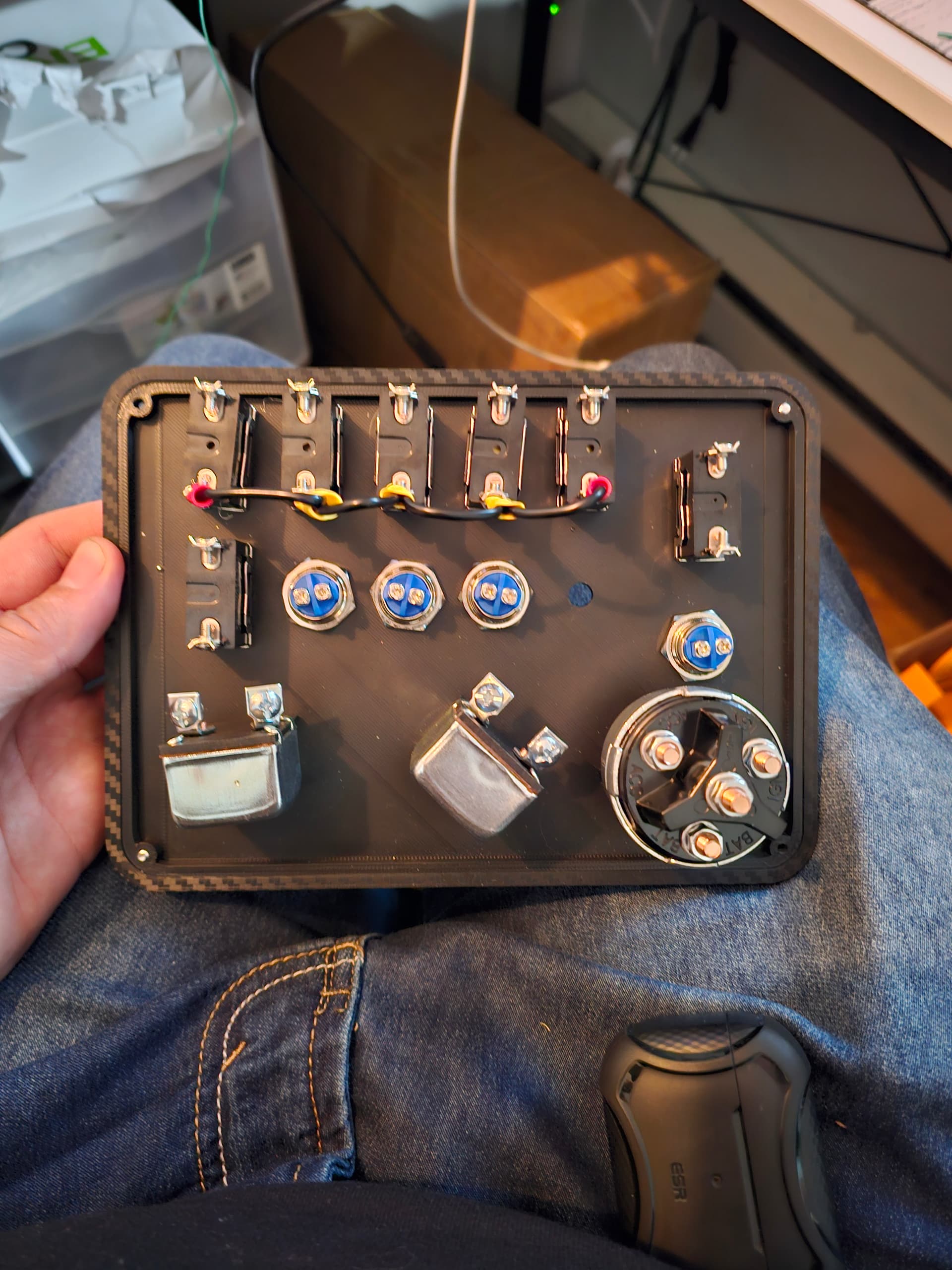

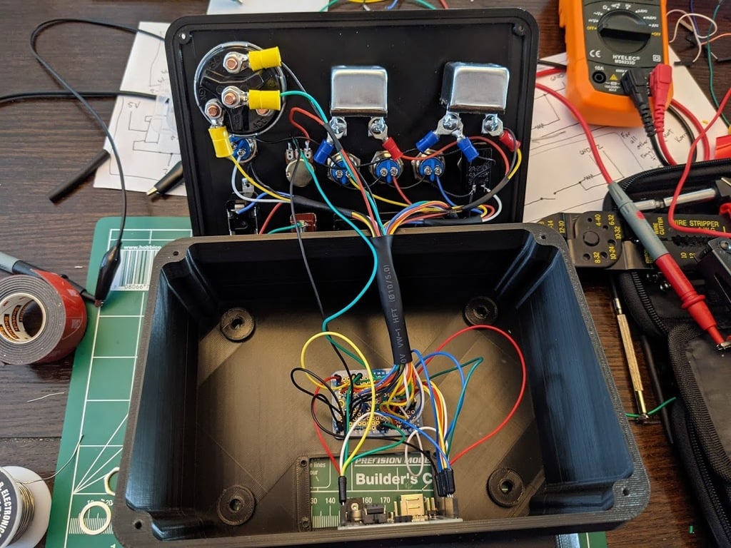

I am making a button box for my truck simulator but all this is new to me I am trying to figure out how to make a button matrix of how to wire it and then how to make the code for an Arduino micro .
if anyone could possibly help me out I will include a front and back picture of the switch and button configuration I will glady pay someone for their time and help to make this setup work.
the 3rd picture is pretty much what I want it set up like
thank you for your time!!!

basicly i want it to be just on off for the switches and the push buttons work as such a single button press. im trying to figure out if i could just wire them all seperately or what ever or could i like wire 5 switches to the same 2 pins on the micro? like maybe the top row of switches to A1 and pin 2? and then do the same with the push buttons. the parking breaks are push pull switches but i would guess that that works the same as an on off switch? im new to all this i was originally just going to use a usb controller board but it has too many buttons to use one of those. because it woulda been really simple positive and gnd for each switch i dont know much about schematics etc
There are technics using resitance ladders between some 5, 6 buttons using analog reading. Matrixing rocker switches.... Don't remember any easy way for that.
Straight wiring drops some library and is straight forward.
The suggestion is: Go for straight wiring. Else diodes soldered are needed and more complex code.....
so can i just wire all the grounds together to ground and then put each positive to a separate pin? does that work ? i found a sketch for a button box the same but it doesnt show how to actually wire it up

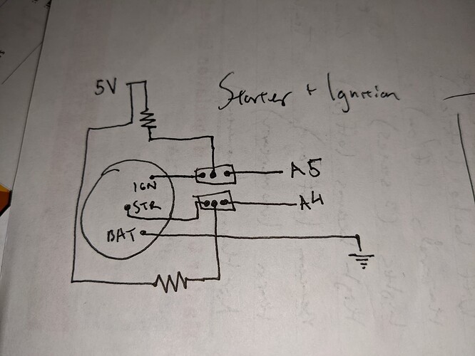

  // Ignition
  int ign = analogRead(A5);
  int str = analogRead(A4);
  if (ign > 500 && str > 500 && ignState == 1)
    Serial.write('e');
    ignState = 0;
    strState = 0;
  if (str < 10 && ignState == 1 && strState != 1)
    Serial.write('e');
    strState = 1;
  if (ign < 100 && ignState != 1)
     Serial.write('e');
     ignState = 1;

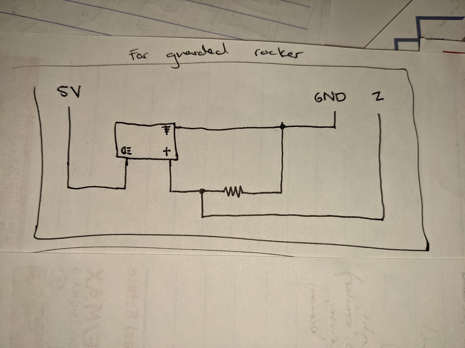

Your pictures in reply #12....
The first picture. The "Bat" cable to GND is likely the middle finger in a rocker switch. Use digital input and INPUT_PULLUP to read it.
The second picture..... Which one of Your switches, or buttons, will that be?
Well all my switches are 2 post switches so im wondering if i should swap them out for 3 finger ones?? The top 7 switches are the just on off toggles but i think the trailer disconnect maybe should be changed to a 3 pin rocker if im correct with that drawing ? Those drawings and the picture are from the original builder of the same kind of box but i dont understand them. At all. I and going to look into it some more thank you all soo much for your input its helping immensely.
Decide which functions You want to build into Your box!
I referred to the Start- Ignition detail.
A 2 post switch is like a button that locks in the 2 different positions.
What are You talking about?
Specify which functions You want to emulate! No need to copy any special things from other projects. It only makes You confused I think.
