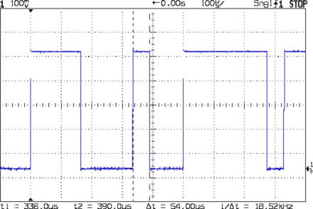

Yes I wrote something like that in 6802 assembly language many years ago.
Here's an updated version:
    // get exclusive or feedback from tap 28 and 31, i.e. bit 27 and 30
    tempXor = (shiftRegister & ((unsigned long)1 << 30)) ^ ((shiftRegister << 3) & ((unsigned long)1 << 30));
    shiftRegister = shiftRegister << 1;
    if (tempXor != 0)
      shiftRegister |= 1;

Hey so what does this code do exactly
It does what you asked for, generates a pseudo random sequence.

The sequence will repeat periodically, period depending on the length of your shift register and where you tap it.

The code I posted would repeat a pattern every 60 hours, at a 10k sampling rate. I don't think you would notice that. :slight_smile: As far as cost, I think something like a Pro Mini and piezo together might be competitive with a Zener/BJT source along with amplifier... even a proto board costs money.
