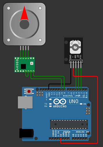

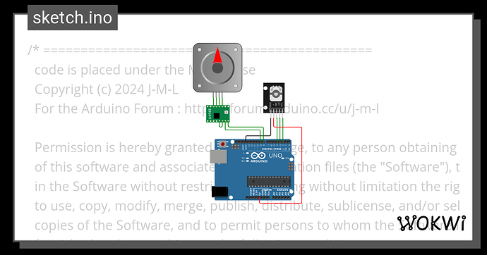

My recommendation would be to use libraries to make your job easy.
Here is what it could look like (the button is the one embedded in the rotary encoder)
In this version I'm using the accelStepper library and a driver, but you could configure the accelStepper instance to suit your needs.

#include <Encoder.h>        // https://www.arduinolibraries.info/libraries/encoder$0
#include <Toggle.h>         // https://www.arduinolibraries.info/libraries/toggle$0
#include <AccelStepper.h>   // https://www.arduinolibraries.info/libraries/accel-stepper$0
const byte encoderCLKPin = 2;
const byte encoderDTPin  = 3;
const byte encoderSWPin  = 4;
const byte dirPin        = 8;
const byte stepPin       = 9;
const float maxSpeed = 400;
const float acceleration = 25;
const long stepsPerFullRotation = 200;
long targetPosition;
Encoder encoder(encoderDTPin, encoderCLKPin);
Toggle encoderSwitch;
AccelStepper stepper(AccelStepper::DRIVER, stepPin, dirPin);
bool encoderChanged() {
  long newPosition = encoder.read() >> 2; // divide by 4 as the rotary sends 4 ticks per click
  if (newPosition != targetPosition) {
    targetPosition = newPosition;
    return true;
  return false;
void testSwitch() {
  encoderSwitch.poll();
  if (encoderSwitch.onPress()) encoder.write(encoder.read() + (stepsPerFullRotation << 2));
void testEncoder() {
  if (encoderChanged()) stepper.moveTo(targetPosition);
  encoderSwitch.begin(encoderSWPin);
  stepper.setMaxSpeed(maxSpeed);
  stepper.setAcceleration(acceleration);
  testEncoder();
  testSwitch();
  stepper.run();
Thanks a lot, that solved my problem :blush:
glad it helped :slight_smile:
