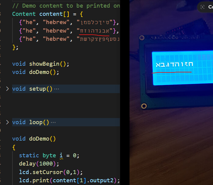

Trying to convert utf-8 to other charset to use a hebrew liquidCrystal
i have an LCD display with a hebrew character set
i'd like to have a function that converts hardcoded utf-8 string to that charachters
from what i can see it's just a difference of 16 between the code sets
so in utf -8 the char i'd like to convert has cod 144 , the target code is 160
i understand that for utf-8 i need to use wchar and not char
problem is i don't see any strlen functions that handle wchar
so i could something like this.
char* convert(const wchar_t * buffer){
    size_t size=strlen(buffer);
    for (size_t i = 1; i < size; i=i+1)
      byte b=buffer[i];
      Serial.println(b);
      byte result;
      if (b>=144 && b<=170){
         result=b+16;
      }else{
        result=b;
      disp->print(0,0,"%c",(char)result);
      disp->print(0,1,"%d",b);

I have a LCD library for private usage which converts UTF-8 characters to the character set in the LCD ROM.
I know nothing about Hebrew, but I tried to implement a converter for that display.
https://werner.rothschopf.net/microcontroller/202012_arduino_liquid_crystal_language_en.htm
You can try the example 5036_Convert_Hebrew as a starter.
the last parameter is the converter you handover to the constructor
LiquidCrystal_PCF8574 lcd(addr, cols, rows, convert_SPLC780D1_015A)
if you prefer to write your own converter, that's also possible.
nice, it does seem to display hebrew chars, i can use that as a basis, i was about to start going over on how to do debugging in arduino platform io
i just need to handle the RTL stuff..
does your library handle string reversal? that's the thing i've been trying do.
hebrew is a right to left language.
i've been trying to do this, but even trying to debug this in normal console c is proving exceedingly difficult because hebrew doesn't even show up on a console in windows.
that's something what should be done by the LCD driver on HW level.
if you add
  lcd.rightToLeft();
  lcd.setCursor(15, 0);                 // set cursor to start position
you'll get a right to left.
You have to call this again after a lcd.clear()

perhaps i have something different..
what is the result from the sketch in #12 after you pressed on or two times the send button?
oh i already did, i had to modify the sample plus re-arranged the method order so it would work with platform.io (and i also included the link to aliexpress display, and modified the address and lcd size.
the project also includes 3 images i too.
NoiascaLiquidCrystalHebrewUsage.zip (1.1 MB)
but in the end it works now?
oh yes, as soon as you said right to left i've applied it. i thought i said that, i was just surprised about the driver part, i'm not familiar with all fine details of the hardware.
fine.
