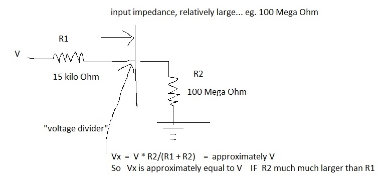

I didn't directly plug the 5V into the A0 input, but added a resistance of 15KOhms between 5V and the input A0. However, my voltmeter (well, the LCD output of my Arduino) gives 4.9-5.0V. Shouldn't it be lower, since I added a resistance?
It would be lower IF the resistance that you had added were much greater than 15 kOhm. The theory is 'voltage divider'. Assuming that the voltage source has relatively small 'source impedance'.... so ignoring voltage source impedance.
Then the voltage divider equation will show that the output voltage of the divider circuit will be approximately the same as the incoming source voltage whenever the newly added series resistance (impedance) is relatively small (compared with the impedance of the load, and the 'load' in this case is arduino "A0").
If the newly added resistance is 'significantly large' (compared with the load), then you get the 'loading effect', which will lead to the voltage measured at output of the divider being much less than the actual source voltage (unless that effect is accounted for).
