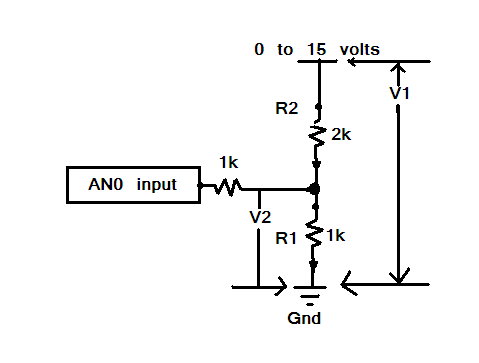

My goal is to read voltage from either a 2S or 3S lipo-battery which means that to read it with my arduino I need to reduce the voltage. I had some 100K and 10K resistors at home so I built a voltage divider using these. I measured the resistors to be R1=98700 and R2=9790. As can be seen in the code I use a variable called voltage_divider that has these values which I use when reading the voltage. The voltage is read using the Vin pin, there I connect R1 & R2 then connect to ground. I read the voltage over R2 into the A0-pin.
The problem is that I get a value that’s close to the correct value but too far away to be acceptable. For example, a voltage of 4.55V reads 4.35V and 11.68V reads 11.45V.
Can anyone spot an obvious error?

To clarify, this picture shows how I’ve done.
What are the exact voltages measured at the battery, the Arduino +5V pin and the analog input pin when it's connected up?
Your voltage divider adds up to about a factor 11, not as a factor 10.
I guess that’s what you are tripping over.
I would change the resistor values to as in my drawing
Then a little math and see if it don’t work better
ADC reading  1000 +2000 = 3000 /1000 = 3
check the chips ADC AREF pin say it's 4.89 volt
you can compensate for that in code
so your math is 1000 +2000 = 3000 /1000 = 3 * 5 =(V1) 15
So a ADC reading of (V2) 5 volts = 15 volts

@be80be Why the extra 1K resistor before the A0-pin?

Boopidoo: @be80be Why the extra 1K resistor before the A0-pin?
I will save you from making a bo bo it limits the current
The voltage divider has to be set for the AREF to get a true reading You pick a voltage range 0 to 15
Then you pick the resistors to read full scale at your AREF voltage is how you get a true reading.

I would go for 20 volts then R1 would be 3k and R2 1K I would use a 2K Trimpot feed 20 volts to it and set the center dead on my VREF.
