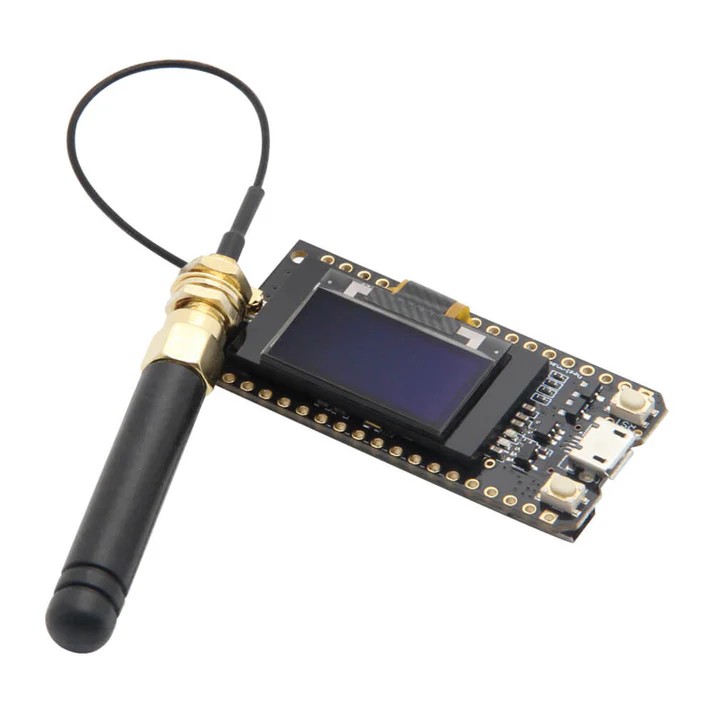

I have a problem getting started with the TTGO LoRa v1.0 board. I use the ESP32 dev board and UART communication doesn't work well. The XTAL is 26MHz obviously and the software thinks it's 40MHz. So the 115200 baudrate is actually 26/40 * 115200 = 74880. How can I correct the XTAL frequency of ESP32 dev board to 26MHz?

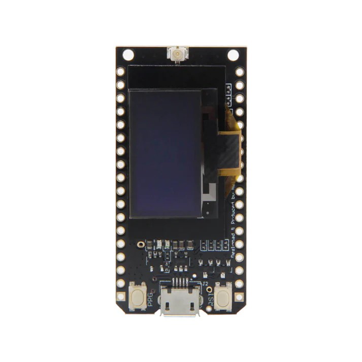

It's the TTGO/Lilygo LoRa32 V1.0. It's this module:
It works with a 26MHz crystal apperently. Normally it the ESP32 works with a 40MHz crystal. But how can I change the MHz of the crystal?

thanks for your answer. I was compiling with the standard ESP32 dev board. Didn't know that this crystal configuration was part of the board, but that only seems logical. I see that you warn for upgrades. I hope I can add my 'own' board, so I know that if the boards are upgraded that it doesn't effect the board I added.
It should be possible using a boards.local.txt.
Note:
I do not where getXtalFrequencyMhz() gets its information from.
If you compile with correct board, you get board revision options where you can select V1 (26mhz) or V2 (40mhz).
