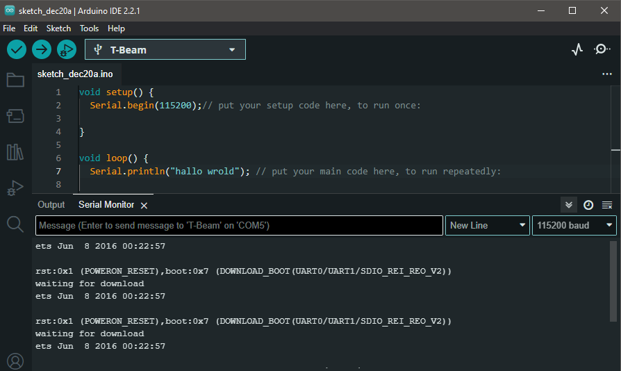

Ttgo t-beam v1.1 rst:0x1 (POWERON_RESET),boot:0x7 (DOWNLOAD_BOOT(UART0/UART1/SDIO_REI_REO_V2)) waiting for download
before I installed my ttgo pin board it could be used normally. However, when I pinned it, the upload was successful but nothing appeared. after pressing reset the output appears. how to solve it?

Hi @takagisan. The output shown in your screenshot:
occurs when pin GPIO0 (I believe this is the pin marked "0" on the board) is connected to ground. You should do a careful visual examination of your board to check if there are any short circuits or conductive debris. Make sure the board is not sitting on a conductive surface or touching conductive objects. Carefully review any external circuitry, wiring, shields, modules you have connected to the board.
I'm not sure I understood correctly what you mean by "pinned it". Please add a forum reply here that provides a more detailed description to help me to understand it.
